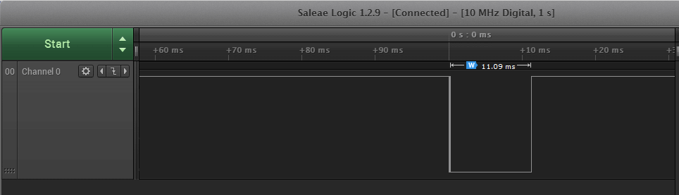

  • I have done a little probing on the reset line and I am not quite sure what is going on with my j-link. I have run this commander script to stimulate the reset line.
    1. device ATSAM4E8C
    2. r
    3. Sleep 10
    4. RSetType 2
    5. Sleep 10
    6. r0
    7. Sleep 10
    8. r1
    9. exit
    std_reset.png is a screenshot from my logic analyzer, you can clearly see the approx. 10ms delay caused by the r0/r1 commands.

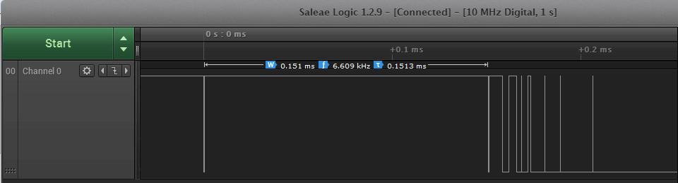

    But if we zoom in we can see quite a bit of mess caused by the earlier reset commands on the reset_mess.png attachment.
    Note: it seems the mess is not related to the first reset commands, they simply do not cause any changes on the reset pin.
