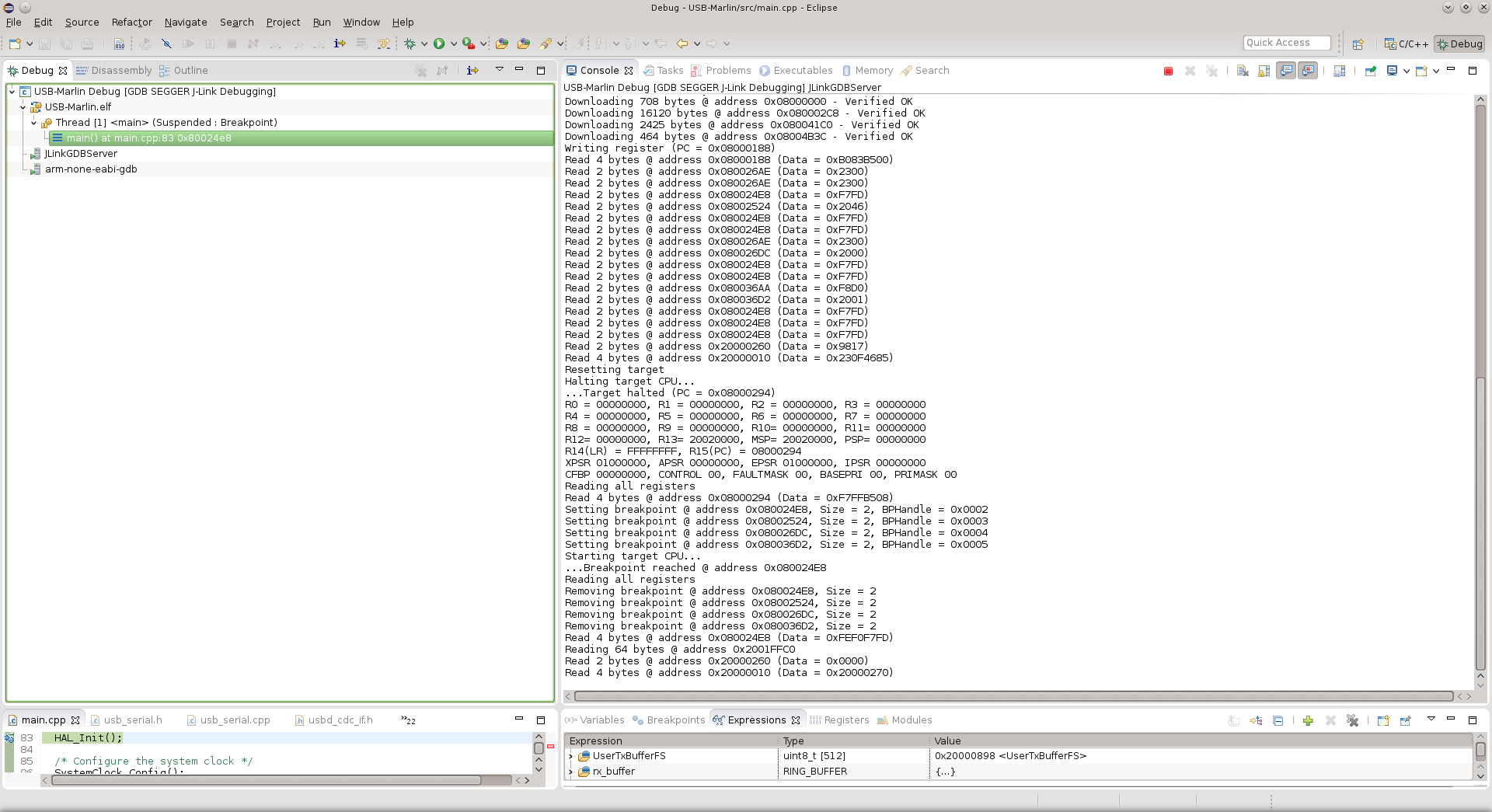

    Hi all,
    I'm working on a Discovery board STM32F4 with jlink+ARM Eclipse plugin+ Eclipse Luna 4.4.0 + GNU Arm toolchain.
    My OS is Opensuse 13.1.
    Jlink worked fine for a while, but now sometimes the debugging initialization process fails: no resume/suspend/terminate menu button are available and the cpu doesn't start.
    JlinkGDBserver and other GDB thread doesn't write out to console no warning or error message.
    To solve it I simply restart my systems with jlink usb cable connected; then it start to work for 1-2 hours till the same problem reappears.
    I have update all Jlink software but the problem persists.
    Plese help me.
    Stefano

  • Hello Stefano,
    When J-Link GDB Server starts and is able to connect to the target, J-Link and target seem to be working.
    When J-Link GDB Server is waiting for a connection, it is started correctly, too.
    Usually GDB Server and GDB print any output when they receive a command.
    To have a look if the communication between GDB and GDB Server or GDB Server and J-Link hangs,
    could you post a GDB Server logfile of a session where this problem occures?
    The other possibility is that the communication between GDB and Eclipse did not work correctly.
    The logfile can be set in the debugger settings of the eclipse plugin.
    Johannes

  • Hi all,
    _ unsetting Initial Reset and Halt flag does not have any effect
    _ JLinkExe gives me the same infomration ( see attachments )
    Image of how eclipse stops is posted.
    Sob...
    Stefano

  • Hi Stefano,
    So far the GDB Server log and the JLinkExe output look good.
    The log shows that GDB Server is behaving correctly and despite from some different memory and register values both logs look identical.
    It also shows that GDB Server sends the response for the last received command.
    Since JLinkExe can communicate with J-Link and the target and GDB Server behaves identical,
    it looks like there is a problem with eclipse or GDB which refuse to work correctly anymore.
    Johannes
  • hi Stefano,
    Thank you for sharing the bug information.
    Since there is no problem on the J-Link side, I will mark the thread as solved
    and hope there will be a fix in Eclipse, soon.
