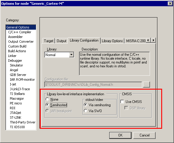

    J-Link does not set any breakpoints on its own.
    It is always the top-level software that controls the DLL which does this.
    In this case, I assume that you are using IAR EWARM for debugging, correct?
    If yes, in your case, the project seems to be configured for using printf() via semihosting, which requires a breakpoint at address 0x8.
    If you do not want this to happen, just change this setting to "None".
    Yes, the breakpoint at 0x8 is mandatory for semihosting calls,
    and will be set when semihosting is enabled in GDB Server (monitor semihosting enable).
    If you do not enable semihosting the breakpoint will not be set automatically.
