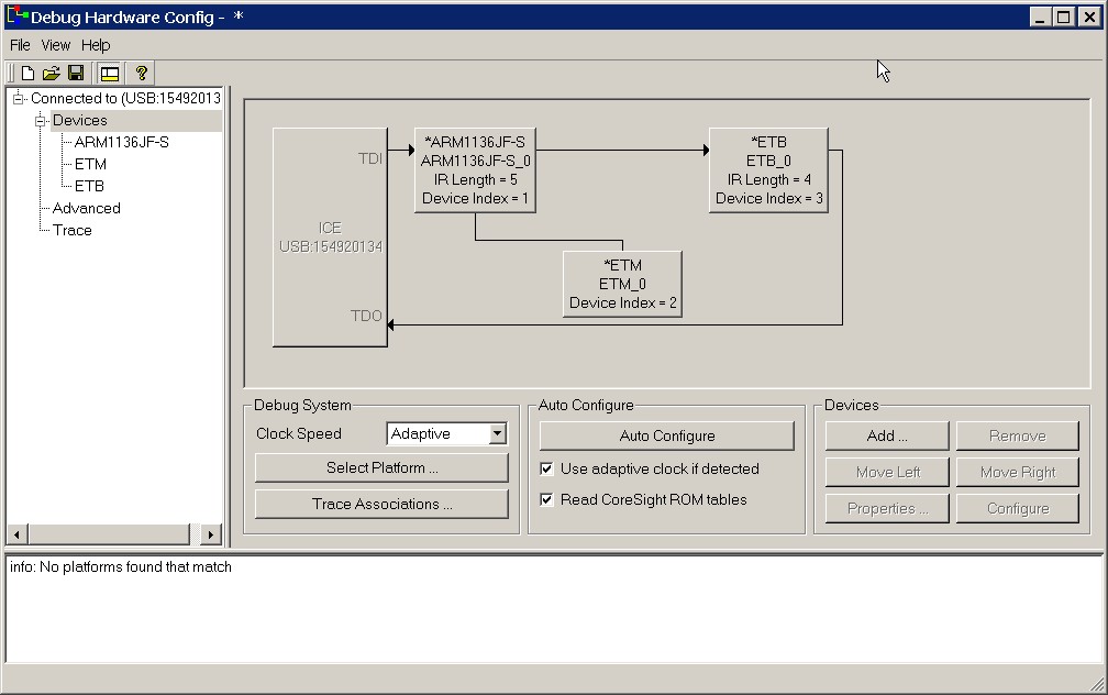

    It seems my Jlink Ultra doesn't recognize ARM11 and Cortex-A9 cores. To double check Jlink Ultra hardware, I connect it to Cortex-M3 core, it works fine. See below commander log screen.
    To also check my boards are working properly, I use ARM RealView ICE and both ARM11 and Cortex-A9 cores are recognized. See screen capture in attachments.
    What could be wrong with my Jlink Ultra setup? Do I need to write some configurartion script to enable the core first and how?
    ARM11: According to your log from J-Link Commander, J-Link measures 2V Target interface voltage
    VTarget = 1.999V
    Is this correct for the ARM11 or is it also a 3.3V devices as the Cortex-A9. If it is, 2V as target interface voltage is definitely to low. This might be the problem here.
    Cortex-A9: Which device are you using here? Maybe the ROM table in the device is not correct, so J-Link auto detection will fail here. (Would not be the first Cortex-A/R based device, where the ROM table is messed up...)
  • Alex,
    1. I am not sure supply voltage is the problem, the ARM RealView ICE can detect both ARM11 and Cortex-A9 (dual cores) as the pictures shown on both boards. Do you mean that J-LINK Ultra will not detect CPU correctly if it senses the supply voltage being 2V?
    2. For Cortex-A9, the picture indicates that first Cortex-A9 core is device index 7 using RealView ICE. What should I do to tell J-LINK Ultra to recognize device 7 in the JTAG chain instead first device? If you can point me tutorial script, proper document, or example, it is appreciated.

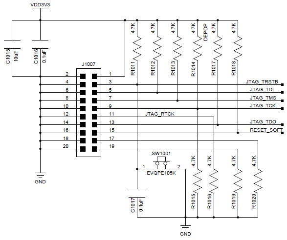

    One more thing: Could you please tell us how you designed the JTAG connector on your board? I asked because you can not use pins 14, 16, 18, 20 as GND reference when using J-Link Ultra because these pins are actually not on GND for J-Link Ultra.
    We have customers which initially used one of these pins as GND reference which caused problems on their hardware.
  • Hi Alex,
    Please see the picture of JTAG 20-pin header on board, it is following ARM's recommendation. TCK is pull-high with R1015 depop.
    Do I need to keep pin-14/16/18/20 float? What are proper connections for JLINK/JLINK-Ultra? I really want to resolve this problem to recommend low cost JLINK/JLINK-Ultra JTAG ICE to my customers, your help is very much appreciated.
