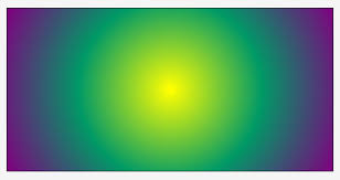

Hi
Is there any way to draw a circular gradient like the attached image by emwin?Thanks All

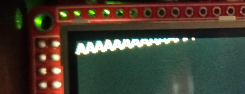

Hello everyone

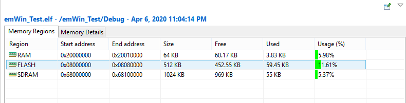

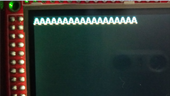

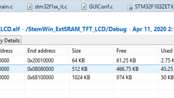

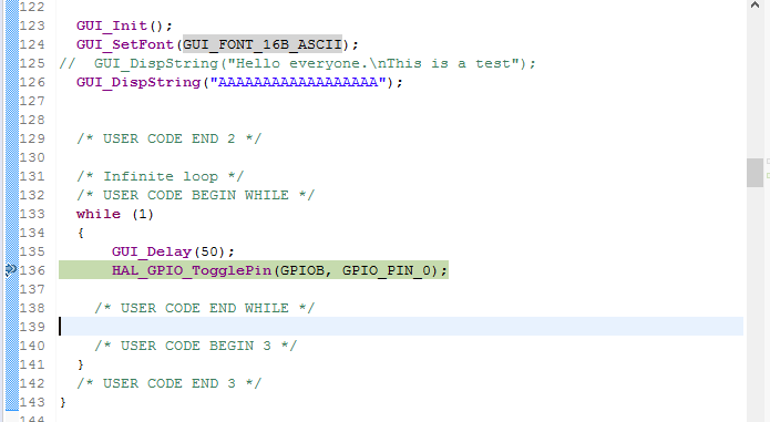

I'm working on STemWin532 library on STM32F103ZET6 bord in STM32CudeIDE. I could successfully configured LCD interface (The Controller is HX8325B and GUI runs on internal RAM) and insert some text on the screen (image 1)But when i use external SRAM as GUI memory result is very strange and interesting :). The text is driven out of the screen. The picture 2 shows the situation.
While the code is the same code that works correctly in the internal RAM of MCU. The only command that i changed is the following variable definition for GUI memory allocation:
C: GUIConf.c#include "GUI.h" #define GUI_NUMBYTES 1024*50 U32 static aMemory[GUI_NUMBYTES/4]; // This is for internal RAM U32 static aMemory[GUI_NUMBYTES/4]__attribute__((section(".GUI_0x68000000"))); // This is for extenal SRAM void GUI_X_Config(void) { GUI_ALLOC_AssignMemory(aMemory, GUI_NUMBYTES); }
The section .GUI_0x68000000 is defined within linker command file as follows:C: Linker
Display More// other codes ............... /* Memories definition */ MEMORY { RAM (xrw) : ORIGIN = 0x20000000, LENGTH = 64K FLASH (rx) : ORIGIN = 0x8000000, LENGTH = 512K ExtSRAM (xrw) : ORIGIN = 0x68000000, LENGTH = 1024K } /* Sections */ SECTIONS { .GUI_0x68000000 : { } >ExtSRAM // other codes....... }

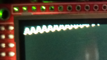

Build Analyzer output of CudeIDE shows the memory usage as image 3.
There is no hard fault in execution procedure and while(1) loop is executing as normal:. (image 4)
Any help will highly appreciated.

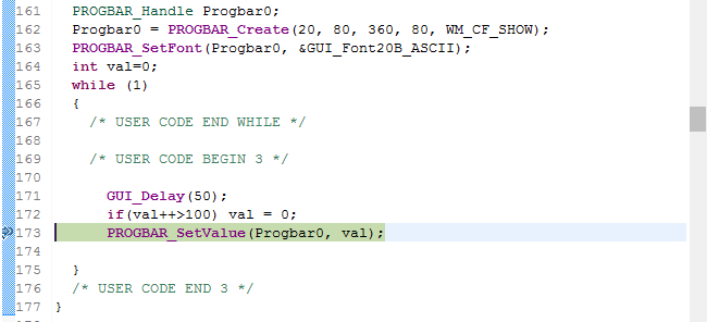

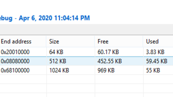

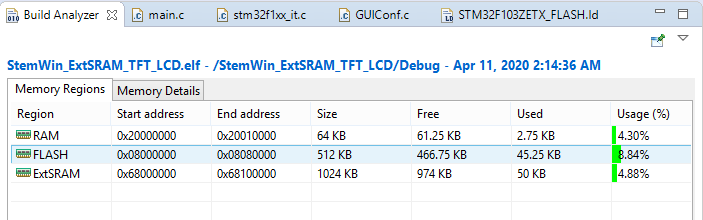

Hi everyone
I'm using STM32F103ZET to run STemWin532 GUI. In the first step i configured everything for running from internal RAM and program worked fine and GUI displayed components like progress bar and ...., but when i changed linker command file to map GUI memory to external SRAM GUI did not work. I checked connection with SRAM and it was OK. I checked 8,16,32 bit memory accessing integrity by following code:C: main.c
Display Moremain() { // initial codes uint8_t static Var8[1000]__attribute__((section(".GUI_RAM")));//.GUI_RAM section is uint16_t static Var16[1000]__attribute__((section(".GUI_RAM")));//located at external SRAM uint32_t static Var32[1000]__attribute__((section(".GUI_RAM"))); uint8_t Read8[1000]; uint16_t Read16[1000]; uint32_t Read32[1000]; for(ii=0;ii<1000;ii++) { Var8[ii]=ii; Var16[ii]=ii; Var32[ii]=ii; } for(ii=0;ii<1000;ii++) { Read8[ii] = Var8[ii]; Read16[ii] = Var16[ii]; Read32[ii] = Var32[ii]; } // other codes }
We can write to External SRAM and read it back successfully.
I attached the STM32CubeIDE Build Analyzer Tool output for memory usage.
In this case (External SRAM) program runs GUI_Init() function successfully and memory allocation and LCD initialization are done, (The LCD is turn to black after GUI_Init() Execution just like when i use the internal RAM as GUI memory) but nothing else happens. Program then execute the following codes in the while(1) loop and screen remains black.
C: main.c
Display MoreGUI_Init(); PROGBAR_Handle Progbar0; Progbar0 = PROGBAR_Create(20, 80, 360, 80, WM_CF_SHOW); PROGBAR_SetFont(Progbar0, &GUI_Font20B_ASCII); int val=0; while (1) { GUI_Delay(50); if(val++>100) val = 0; PROGBAR_SetValue(Progbar0, val); }
I placed break point inside the while(1) to making sure that program is running.(Second attached file)
Thanks
