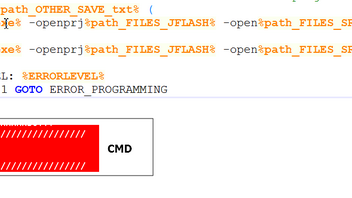

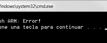

I have a problem with JFLASH (V6.84) that was solved some months ago in this other thread.
I want to program the serial number using the file "..._Project_Serial.txt". However, Jflash always asks for "_Project_SNList.txt", as you can see in the attached image.Although I don't use "_Project_SNList.txt", the serial number and the program are correctly saved in memory. The problem is that JFLASH returns ERRORLEVEL = 1, so my batch file fails all the time (see attached image).

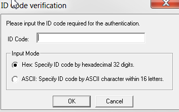

Hello Fabian,
I don't know if I'm doing anything wrong, but it's not working. Every time I try to unlock the microcontroller using -setcpuidcode the ID Code verification window appears and I have to unlock it manually.Maybe I didn't understand the functionality of -setcpuidcode and -setrxidcode?

Hello
I want to create a batch file that unlocks one microcontroller before writing , but I'm not sure how to do it.
Reading the manual I saw two options: -setcpuidcode and -setrxidcode. This is what I'm trying to do, but it's not working because JFLASH always shows the id code window:
Code%path_JFLASH_exe% -openprj%path_FILES_JFLASH% -setrxidcode%XXXXXXXXXXXXXXXXXXXXXXXXXXXXXXXX% -startapp -hide -exit
- It's not clear to me after reading the description what the difference is between -setcpuidcode and -setrxidcode.
- Does -setrxidcode go before or after -startapp?
- Does the id code should go between percentage signs?Regards

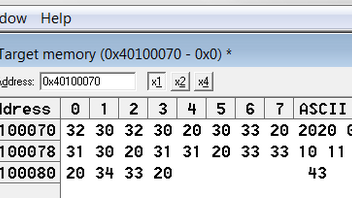

I'm using the command line option readrange to get some data stored in my MCU. It works well and shows the data read as you can see in "readrange.png":
Codecd C:\Program Files (x86)\SEGGER\JLink JFlash.exe -openprj%~dp0\SerialNumberDataFlash.jflash -readrange0x40100070,0x40100083 IF ERRORLEVEL 1 GOTO ERROR :ERROR echo %ERRORLEVEL% ECHO J-Flash ARM: Error! pause
Now, I want to save that data, but it's not working.
- Save command:This code doesn't return error, but it doesn't save the data on my hard drive. How can I tell the code where to store it?
- Saveas command:
CodeJFlash.exe -openprj%~dp0\SerialNumberDataFlash.jflash -readrange0x40100070,0x40100083 -saveas%~dp0\Data.bin
This code returns ERRORLEVEL = 1
What am I doing wrong?

Hello
I'm using SEGGER JFLASH V6.62d, Flasher Portable Plus and a microcontroller from Renesas (S3A6).
When I activate the "Program serial number" checkbox, the serial number 133 (0x84) is written correctly at address 0x40100080. I can verify this by running the command "Read back --> Entire chip".
After that, I perform a complete erasure of the memory with "Erase chip (F4)". The entire memory is written with 0xff, including address 0x40100080.
Then, I uncheck the "Program serial number" checkbox to prevent the serial number from being written this time. But, when I program and read back again, the address 0x40100080 has the value 133 (0x84) again.
