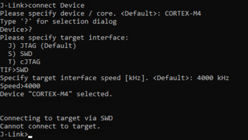

I am working on ARM Cortex M4 development board provided by Vorago technologies. I am using keil IDE with "debug Jlink/J-trace Cortex".
In the driver setup setting, there is no IDCODE getting detected and when I try to flash there is an error popping up with "No Cortex-M SW Device found".
I tried running RTT viewer, the error in RTT is viewer is "Could not connect to target"
When I try to connect to using j-link commander, I can see that device is powered (VTref=3.3V) but still when the try to establish connection there is an error "Cannot connect to target"
How to resolve it?

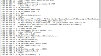

I am working on ARM Cortex M4 development board provided by Vorago technologies. I am using keil IDE with Jlink/J-trace Cortex. When I enable the "Trace"(look in attachement for settings), the debugging session is getting terminated with an error "Trace HW not present" followed by "Error: Target DLL has been cancelled. Debugger Aborted!". Also, find the j-link log file in the attachment

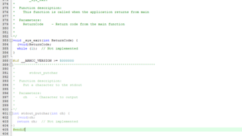

Hi Nino,
Thanks for the suggestion. I made the changes in ''Run time environment'. After making the additional changes at 'Public const' and '_sys_exit' (can refer to attachments), still i am getting the follwing errors

I am working on ARM Cortex M4 processor with Keil MDK. While compiling the project, I am getting the following error. From the Error I understood that there is a multiple definition and I need to get rid of one. Can someone please tell me what is the possible solution for the error and how to implement it.
