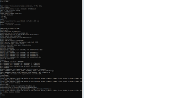

Here for reference same file, same computer, using edbg on SAMD21XPLAINED pro
I now did some more testing, tried to reproduce the steps you did, still no luck.

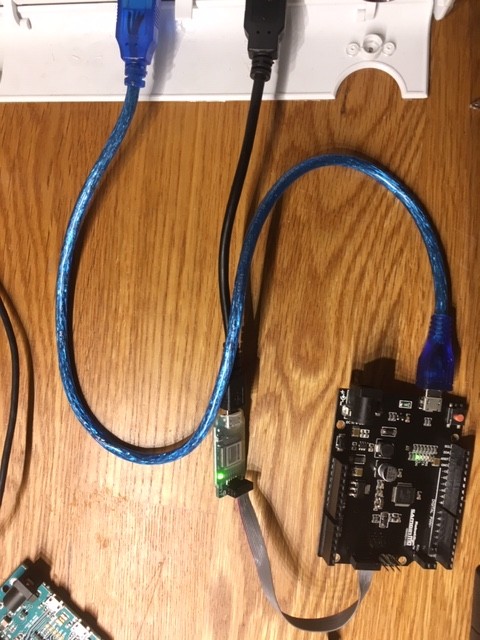

I tried two Arduino Zeros and one Robodyn Board. I also tried to connect the 10 pin header turned 180 degrees, only difference is that I see the Secured Atmel SAMD device message in every case (also on the Robodyn where I do not get that message when I connect properly.

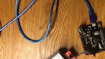

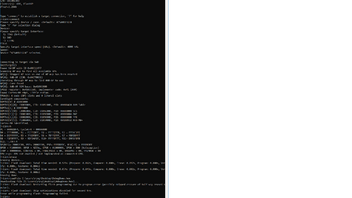

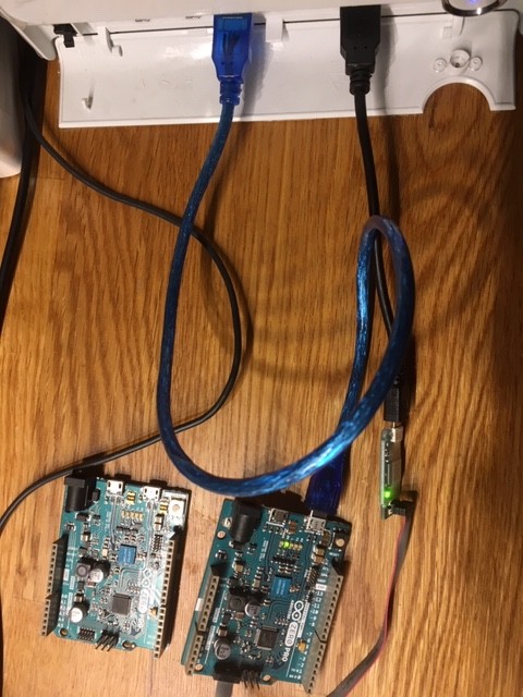

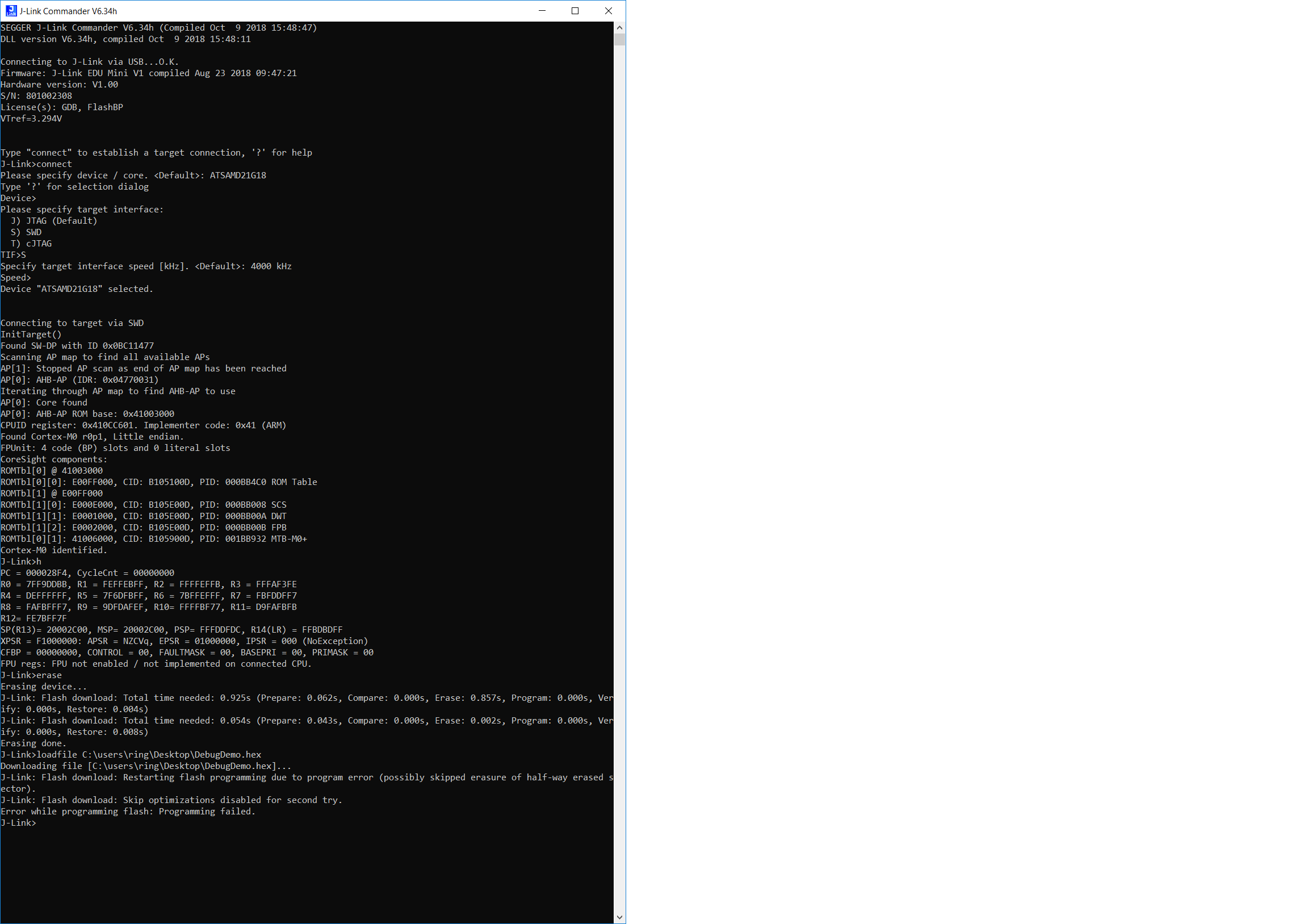

Hi, I am unable to program this chip with either JLink Edu Mini, JLink Edu or on board with an Arduino Zero.
I can program ATSAMD21J18, ATSAMD20J18 and ATSAMC21J18 (All XPro boards) without any issue but for the ATSAMD21G18 I am completely out of luck.
I have one Arduino Zero, one Robodyn Clone with only 10pin connector and a MKRZero, they all show the same error message:Restarting due to program error (possibly skipped erasure of half-way erased sector).
Skip optimizations disabled for second try.(Logs are attached)
I read in another thread in the forum that USB cables may play a role with this issue so I tried five different Cables, result is always the same.
I also tried on my Mac and on a Windows 10 PC, same result on both computers, flashing fails.Any help greatly appreciated,
