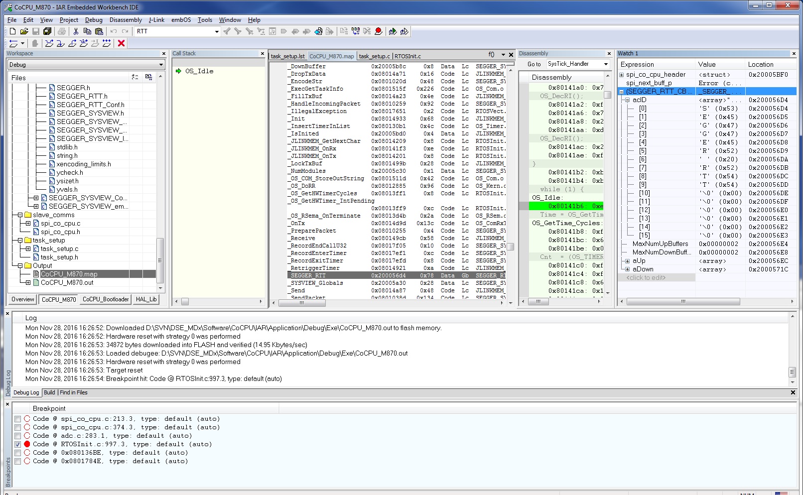

    Hi Martin,
    I am still seeing the issue.
    I can run one of your test projects that use system view OK.
    In our own project though this is not the case.
    I can also see us running through code that initialises this block.
    As per the attachment picture.
    Yet all attempt to connect to the target fail.
    Owain
    Just trying to get system view working on a STM32F205.
    Have updated the embos from an ancient 2009 release to latest embOS_CortexM_IAR_V6_OBJ_V4261_OS-00732_58B82A34_161118.
    OS looks to be running seeing system ticks, trying to start logging, enter in address of RTT control block.
    The I see pop-up....
    Failed to start recording.
    J-Link or target not connected.
    Target not running.
    System View module not configured.
    Am using system view V2.40a, my IAR version installed is 7.40.2
    Be grateful for any hints.
    Owain
