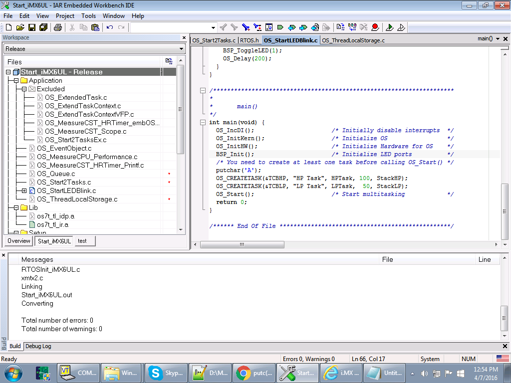

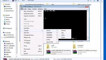

    I downloaded the embOS trial version source code(embOS_ARM_IAR_V6_Trial_V414.zip) from https://www.segger.com/downloads/embos link i successfully build the LED blink application code on the IAR(Version 7.60) for freescale's imx6ul processor.
    Now my task is to run LED blink application on MCIMX6UL-EVK board.for this i am loading .bin(output binary file) to SD card through loads command (through teraterm) but its hanged somewhere(plz see screen shot) so for check i used putchar() instruction for print but situation continues.So my question is how can print get works? do i have to write some driver for print or i am missing something.
    I am attaching u the some screen shots(booting sequence,IAR workbench) so please find the attachment and guide in a proper way.
