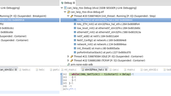

would it make sense to use this kind of stack unwinding also for normal interrupts?
I would like to see in the unwound call stack where I will resume execution when I return from the ISR.
did you think about that before?
to clarify my thoughts, take a look at the attached picture. it shows the callstack before and after stepping out of the ISR.
best regards

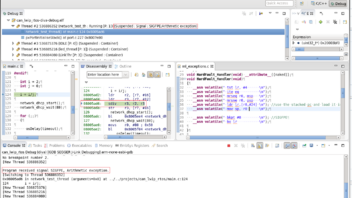

Hi Arne,
I tested the binary you supplied. It's perfect!
For a test, I hardcoded the SIGFPE (#8 ) Signal which is shown in the debugger view in eclipse. perfect!
after the excpetion, the pc points at the exact instruction which caused it. perfect!
it is do be discussed what amount of exception identification can be done on the target / gdb server.
I find your suggestion with different "bkpt #X && bx lr" combinations great.
during the last weeks, you winded up the quality of embedded debugging by a huge leap, congratulations for that! I really like the results of it!
your interaction with this forum is remarkable and very welcome at our side
hope this Proof of Example can find its way into one of the next stable versions.
Best Regards
Peter

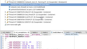

ooookayy...
it seems like I used the wrong offset to get the stacked lr from the stack frame.
I was confused because the this hardfault handler uses offset 5 as lr...
if I take the lr pc with an offset of 24 bytes, and write it to the lr, the call stack is even more beautiful once the breakpoint instruction is hit.
see the attached screenshot.
how can I make the debug view focused on that lr address? like manipulating the pc and trigger another breakpoint after one instruction, is that possible?
maybe setting up some breakpoint register and making a branch to lr?
edit:
I think we got a bit confused here about the lr offsets. the stacked lr is indeed at offset 20(!). but in the current scenario, we are more interested to restore the stacked pc!
and this is at offset 24.
I tried to use the stacked lr
__asm volatile(" tst lr, #4 \n" );
__asm volatile(" ite eq \n" );
__asm volatile(" mrseq r0, msp \n" );
__asm volatile(" mrsne r0, psp \n" );
__asm volatile(" ldr lr, [r0,#20] \n" ); //use the stacked lr
but this did not produce good results.
for now, I'm getting the best results when I write the actual msp/psp to the sp.
what is your impression?
