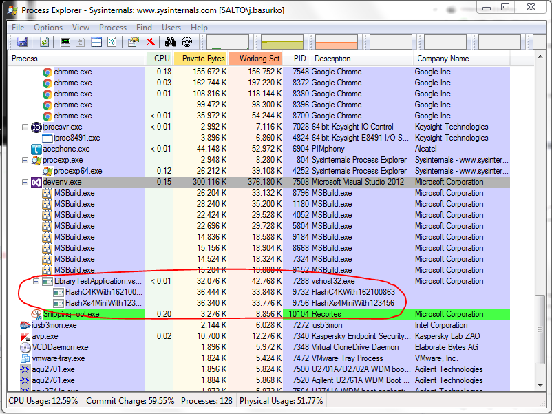

Good morning Niklas,
As you can see in the attached file I create two different processes from the same parent process and each one has it's own copy of the dll library.
I am also sure that each J-Link device is correctly selected because they are connected to two different circuits and once the proccess is ended both circuits are correctly flashed.
Josu.
Good morning,
We have been successfully flashing different microprocessors with different J-Link devices through a "home made" .NET application that uses the J-Link SDK. Now our goal is to be able to flash multiple devices at the same time with multiple J-Links.
So far we are able to do this but we have noticed that the flashing process is being serialized by the dll library. In other words, devices are being flashed sequentially so there is no time saving and no advantage over using a single J-Link.
Searching around the forum I found this from "SEGGER - Alex". It looks clear that as long as we use a single dll library every device is going to be flashed sequentially. Well, we simply created a copy of the application we are using and we executed two instances of the same application from different copies in order to use to different copies of the dll library. Sadly the result has been the same, one of the flashers waits for the other to finish before starting to flash and in the end of the day the time spent in flashing to devices is almost the same as doing it with a single J-Link device.
Is this the expected behaviour? Is there something we are missing or doing wrong?
Thanks.
Josu
