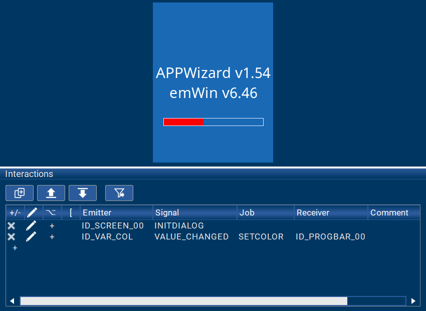

void ID_SCREEN_00__APPW_NOTIFICATION_INITDIALOG(APPW_ACTION_ITEM * pAction, WM_HWIN hScreen, WM_MESSAGE * pMsg, int * pResult) {
GUI_USE_PARA(pAction);
GUI_USE_PARA(hScreen);
GUI_USE_PARA(pMsg);
GUI_USE_PARA(pResult);
APPW_SetVarData(ID_VAR_COL, GUI_GREEN);
Maybe you should check if you set a color within the properties of the progbar in AppWizard does this shows correct color without adding C-code.
