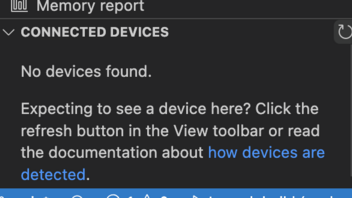

    I just received my J-Link Plus compact and connected it to computer and PineTime DK, but in VS Code using nRF Connect I don't see it listed under Connected Devices. When I unplug it and plug in my nRF52DK and hit refresh the board appears. Whey doesn't the J-Link?
    I am using VS Code with nRF Connect and trying to connect to a PineTime with a J-Link Plus Compact, but am getting this message in vscode:
    The connections look like this, which all seem correct:
