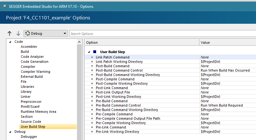

    I am not sure if we mean the same.
    Post-build steps happen after the build, not involving any build tools (compiler, linker).
    This are usually external tools, or batches/scripts.
    In the example I mentioned, this is a self-written tool that reads/parses the build artifact (an *.S19 file in this case), calculates a checksum over a given address range, and patches this checksum into the build artifact.
    In other cases, these are output format converters (Bin, Hex, S19, ...).
    In your case, I would suggest to have a look at the srec-tools (https://srecord.sourceforge.net).
    It is a powerful tool to convert, split, join and manipulate FLASH/EEPROM file formats like Hex, S19 and many others.
    The idea is to add the call the tool into the post-build step setup, or use a script (batch) for more complex tasks requiring multiple passes.
    I would use a post-build command.
    This can be found in Code->User Build Step in the project options.
    Her a screenshot from a private project of mine:
    Basically all modern toolchains have such an option.
    My company uses it extensively to similiar purposes, like calculating a checksum over the Hex/S19 output and patch the checksum into the ex/S19 artifact.
