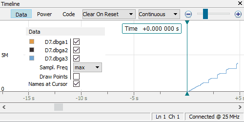

    I made similar observations (win10, ozone 3.36, j-link ultra+ v5.1). quick example:
    I have these variables:
    I want to sample D7.dbga[1-3] or dbgb[1-3] or dbgc[1-3]
    All variables are in the same memory (DTCM of a STM32H745 in this case)
    Sampling with max frequency results in requests send every ~20us on the SWD lines running at 25MHz.
    observations:
    sampling D7.dbga[1-3]
    =>GUI very laggy, many sample points missing
    sampling dbgb[1-3]
    =>GUI laggy, some sample points missing
    (but one time this also ran smoothly)

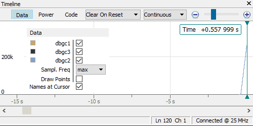

    sampling dbgc[1-3]
    => ok
    sampling <artificial>::dbgb[1-3] (result of "graph" in context menu of GlobalData pane)
    sampling (<artificial>::D7).dbga[1-3] (result of "graph" in context menu of GlobalData pane)
    =>GUI very very laggy, many sample points missing
    sampling addresses directly

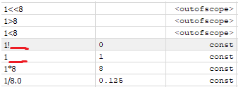

    22. don't reset the sampling when I change an expression, just recalculate (unless the sampled variables change)
    e.g. when I have two variables, one that goes from 0..1 and one from 0..1000, which I only realize after they got sampled. Then I may want to add "/1000" in order to scale the waveform, so I can see the small values as well. But that needlessly resets the sampling and removes the data.
    Is this also the solution for the still not working watched data expressions? Just calculate it on the target ?!
