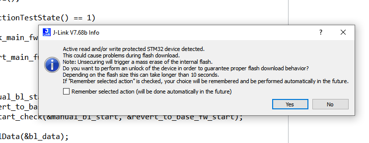

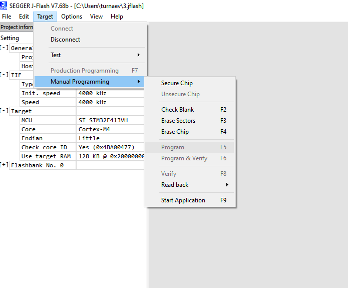

Hello!
I use J-Link Plus HW10.1.
I recently upgraded J-Link software to version 7 and ran into a memory cleanup error issue. The last four sectors in STM32F413VH are not cleared.
I did some research, installed software versions from 7.00 to 7.68b, both 32 and 64 bits. The last correctly working version is 6.98e.
J-Flash and J-Flash Lite give the same memory clearing error when trying to clear the last 4 sectors.
At the same time, before cleaning, a message is displayed stating that the controller is write-protected and it is proposed to remove the protection. However, the write protection is not removed.
It helps only clearing these security bits through the ST-Link emulator and their software.
I tried updating the J-Link firmware, both to the latest and to the 2019 version, there is no difference.
If the controller was locked, then I can no longer clear it, even if I remove version 7 software and try to do it through version 6, it will give the same error and clear nothing.
Please check and fix this annoying bug in your software.
