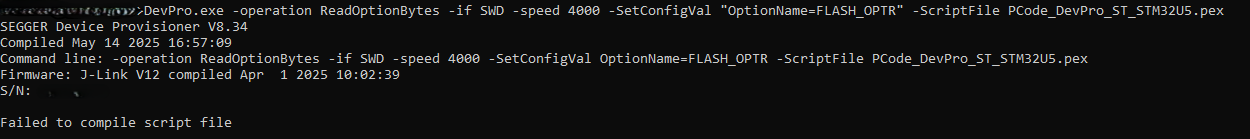

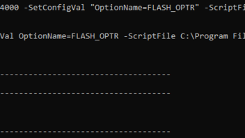

    I've noticed, that from V8.24 on, at least the "PCode_DevPro_ST_STM32U5.pex" script is not working ... but using V8.24 and older versions without any problem.

    Could you try specifying the full path to the .pex file and see if that resolves the problem?

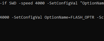

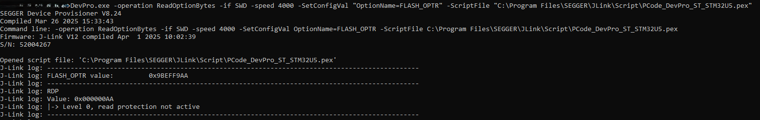

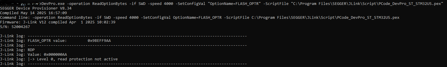

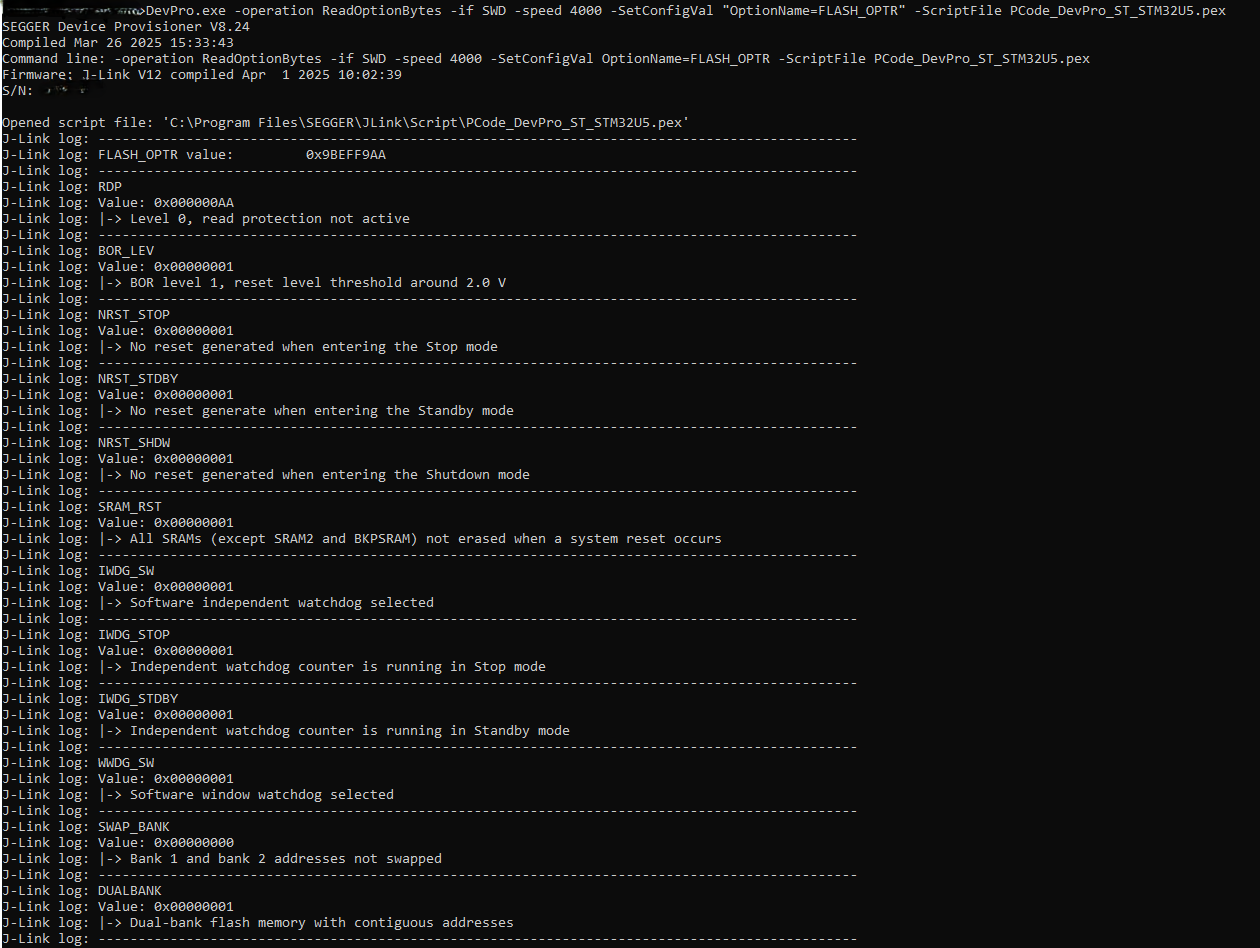

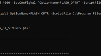

  • Simon hi,
    yes, it seems that full path approach has a working results ... results attached (V8.24 and V8.34).
    Used full path command:
    DevPro.exe -operation ReadOptionBytes -if SWD -speed 4000 -SetConfigVal "OptionName=FLASH_OPTR" -ScriptFile "C:\Program Files\SEGGER\JLink\Script\PCode_DevPro_ST_STM32U5.pex"
    It would be appreciated, if backward compatibility using just -ScriptFile PCode_DevPro_ST_STM32U5.pex is preserved.
