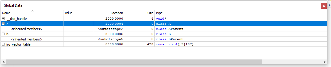

Derived class members are outofscope when debugging C++

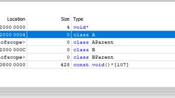

    We are having a hard time debugging our code base which is primarily C++ based. Class members in derived classes are shown as "outofscope" in some cases. In the following example, a.var1, a.var2, b.var1 and b.var2 are "outofscope". If A class is not instatiated, b.var1 and b.var2 are visible as expected which is strange.
    The issue is not present if the code is compiled with Segger Embedded Studio
    Stm32F439
    Ozone 3.38f
    -O0
    GCC toolchain 12.2 (same issue on 14.2)
