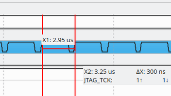

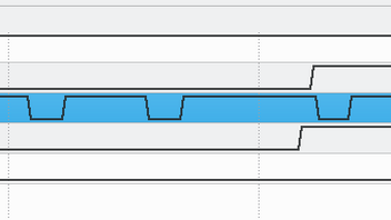

    Connecting at 2 MHz works fine but fails at 4 MHz.
    I took two screenshots in my logic analyzer and it is clearly visible that the duty cycle gets worse with higher frequency (it looks ~50/50 at lower frequencies such as 400 kHz). In addition, TCK for 4 MHz setting measures as 3.33 MHz.
    I just wanted to check if this is expected behavior.
