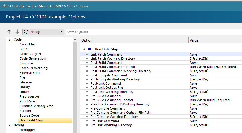

    Replied to the thread SES - Multiple HEX output variations.
    Post
    I would use a post-build command. This can be found in Code->User Build Step in the project options. Her a screenshot from a private project of mine: forum.segger.com/index.php/Att…e43b163d454f05ea561b04d2d Basically all modern toolchains have such an…
