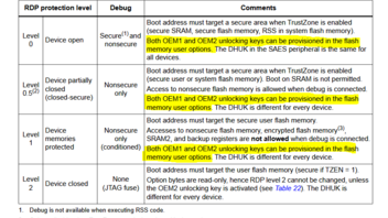

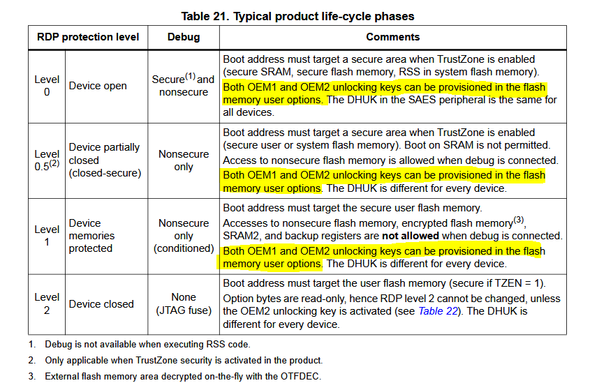

      There are 2 keys (OEM key1 and key2 )that can be provisioned for RDP regression on the stm32u5.
      When the device is in RDP level 0 or 1, I can provision both keys fine using the devpro tool.
      But when the device is in RDP level 0.5, the tool is failing to provision both keys.
      When you say " Setting the password for RDP level 0.5 is not supported by the DevPro"
      Do you mean when the device is in RDP level 0.5, key provisioning is not supported? or Are you referring to provisioning the specific key that is used for RDP 0.5 regression?
      I have attached a table from the stm32u5 reference manual that can provide some more context.
