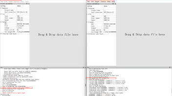

      Hi, I meet the "Failed to measure CPU clock frequency" error when I use jlink software version is up than 786h
      The J-Flash log windows shows
      • When the jlink software version is 7.86h, "CPU speed could not be measured" --> the CPU speeed could not be meausred but Jlink NOT treat it's an ERROR and continue the programming
      • When the jlink software version is 8.12b, "Failed to measure CPU clock frequency" --> the CPU speeed could not be meausred and Jlink thinks it's an ERROR
      By the way, The Keil and IAR works fine with the jlink 8.12b.
      Is this a jlink software bug?
      How to fix this?
      Or is there a way to skip "CPU speed measured" ?
      Thanks!
