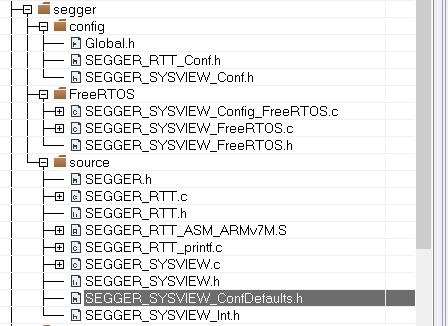

      2. Add these files in the IAR project. Please see attached "Segger_Integration_Files.png":
      /Config/Global.h
      /Config/SEGGER_RTT_Conf.h
      /Config/SEGGER_SYSVIEW_Conf.h
      /FreeRTOS/Config/Cortex-M/SEGGER_SYSVIEW_Config_FreeRTOS.c
      /FreeRTOS/SEGGER_SYSVIEW_FreeRTOS.c
      /FreeRTOS/SEGGER_SYSVIEW_FreeRTOS.h
      /Source/SEGGER.h
      /Source/SEGGER_RTT.c
      /Source/SEGGER_RTT.h
      /Source/SEGGER_RTT_ASM_ARMv7M.S
      /Source/SEGGER_RTT_printf.c
      /Source/SEGGER_SYSVIEW.c
      /Source/SEGGER_SYSVIEW.h
      /Source/SEGGER_SYSVIEW_ConfDefaults.h
      /Source/SEGGER_SYSVIEW_Int.h

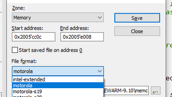

      After the above changes, I got the build passed. So I started my firmware and then paused it. I checked _SEGGER_RTT. I tried to export the data. But there is no way in IAR to export the data as "Raw Binary". I can't save it as SVdat format. Please see attached "IAR_Save_Memory.png". How can I export the memory data as binary in IAR?

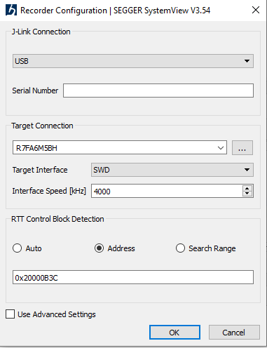

      I also tried to get the Continuous Recording working. In SystemView, I configured the JLink. Please see attched "Segger_SystemView_RecorderConfig.png". I hit the "Start Recording" button. After running 1% for a couple of seconds, the execution stopped. There is nothing showing up in the SystemView. Could you please point out where I did it wrong?

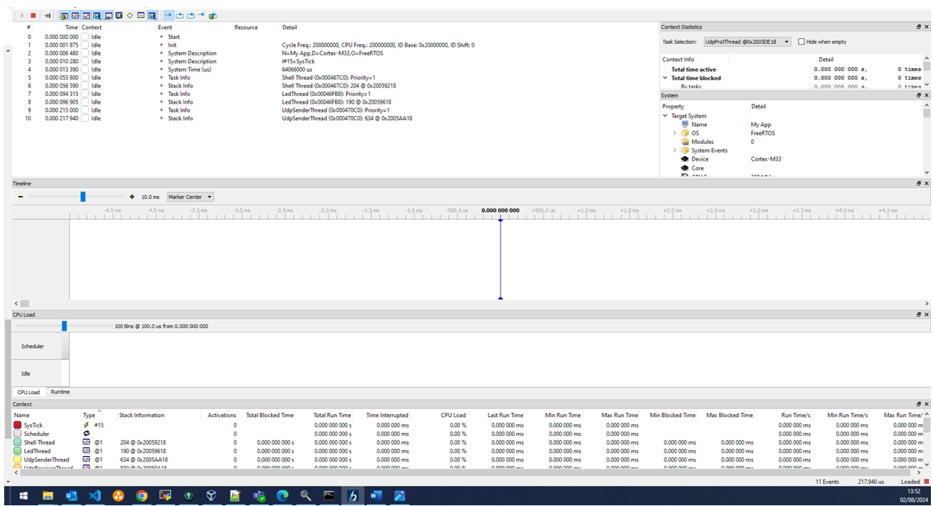

      I am also in similar situation. Also using FreeRTOS 10.4.3. I've been able to get some information back from the device before the SystemView (v3.54) crashes. See profile_log.PNG attached.
      One thing to add, is that I had to manually add
      1. #define RTT_USE_ASM (0)
      to SEGGER_RTT_Config.h because it could not link the `.S` for ARMV7, since I am using Renesas R7FA6M5BH which is ARMV8, I thought that would be ok. I found this here (link).
      I can compile and run my FreeRTOS application, but cannot understand why the SystemViewer is crashing. If anyone from SEGGER could give some insights that would be very much appreciated. I have attached the crash log from Windows. WERF4A2.tmp.WERInternalMetadata.xml
      The application seems to crash after some data has been received from the FreeRTOS via J-Link. I have found that in the Recorder Configuration, I need to tell where the RTT Control Block is, so I just point it to the location in RAM (0x20000B3C).
