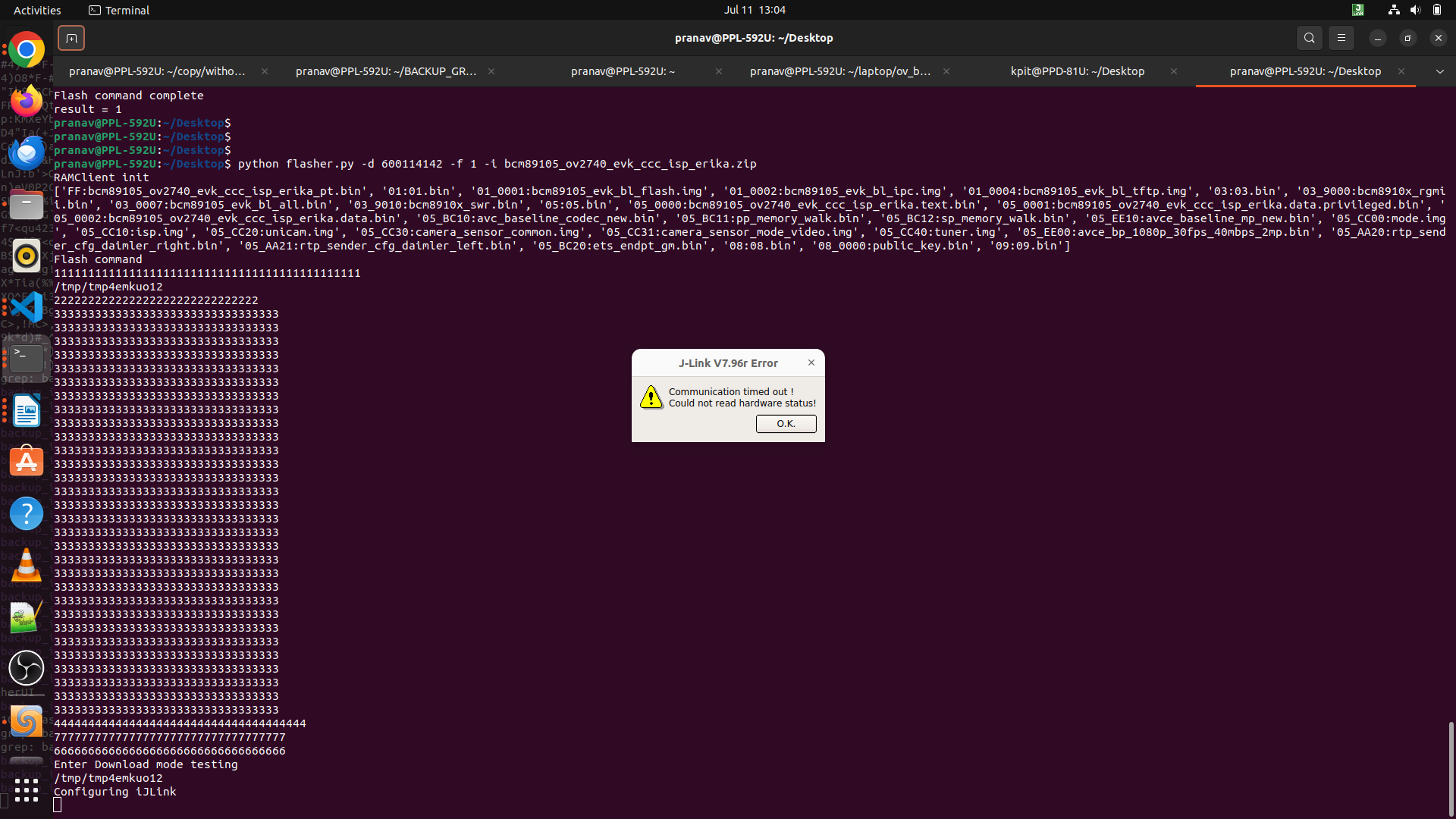

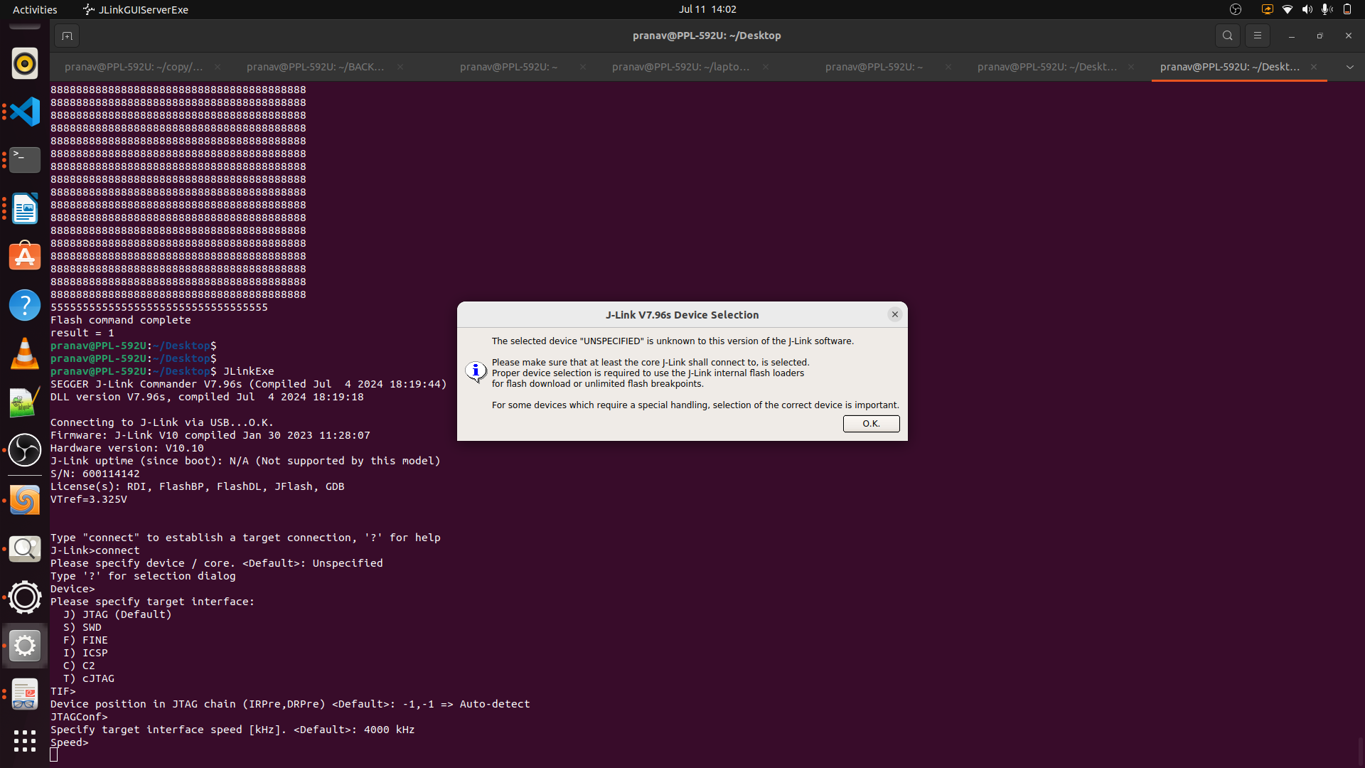

    I have tried flashing with Jlink S/N:- 600114142.
    But In that Jlink i am facing below issue .
    I am using ARM CORTEX M, i have mention below setting which i am using .
    self.iJLink.JLINKARM_SetSpeed(5000) # 5000 kHz
    self.iJLink.JLINKARM_CORE_Select(0x0E0100FF) # JLINK_CORE_CORTEX_M7
    self.iJLink.JLINKARM_TIF_Select(0) # JLINKARM_TIF_JTAG
    With this J link i am facing below error , Jlink connection is not happening and i am not able to read memory , for setting side if i missing anything , please let me know.

    Could you please send us a J-Link log file of the failing scenario?
    How to enable: wiki.segger.com/J-Link_DLL#Enable_J-Link_Log_File
    The S/N you have sent is from a unit from 2019 which is out of support and warranty.
    We recommend to make use of our trade-in program:
    segger.com/purchase/trade-in-program/
    In the J-Link Commander, you need to select a device in order to connect to your core.
    In your case, select "CORTEX-M7".
