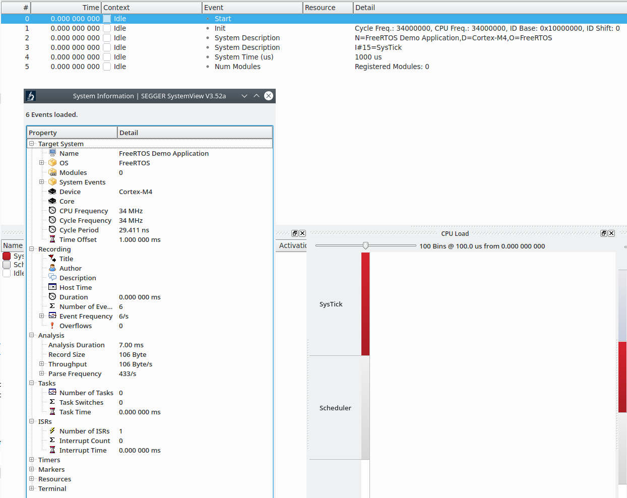

Is an ETM required in the target for SystemView to function? GD32F405
    • Is an ETM required in the target for SystemView to function? GD32F405
      I'm trying to set up a profile environment for the GD32F405 in SystemView using FreeRTOS 11. However it seems to be getting stuck with the following log and silently failing:

      It's definitely seeing the RTT control block as pressing "read recorded data" gives this further information
      1. 16:30:12 - JLink: [0][0]: E000E000 CID B105E00D PID 000BB00C SCS-M7
      2. 16:30:12 - JLink: [0][1]: E0001000 CID B105E00D PID 003BB002 DWT
      3. 16:30:12 - JLink: [0][2]: E0002000 CID B105E00D PID 002BB003 FPB
      4. 16:30:12 - JLink: [0][3]: E0000000 CID B105E00D PID 003BB001 ITM
      5. 16:30:12 - JLink: [0][4]: E0040000 CID B105900D PID 000BB9A1 TPIU
      6. 16:30:12 - JLink: [0][5]: E0041000 CID 00000000 PID 00000000 ???
      7. 16:30:13 - RTT Control Block found at 0x1000F9B4.
      8. 16:30:13 - SystemView Buffer found.
      9. 16:30:13 - SystemView Buffer is empty!
      10. 16:30:13 - Warning: Failed to read recorded data.
      Using the segger_sysview_start(); in code, I manage to pull the following data from the device using the "read recorded information" command:
      I believe I've managed to get this working in the past, though no longer have the original code find any differences.
      Any help would be really appreciated.
