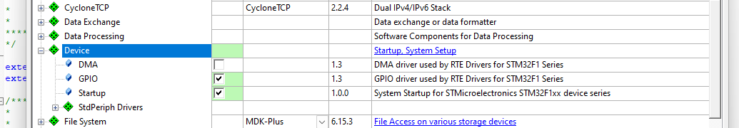

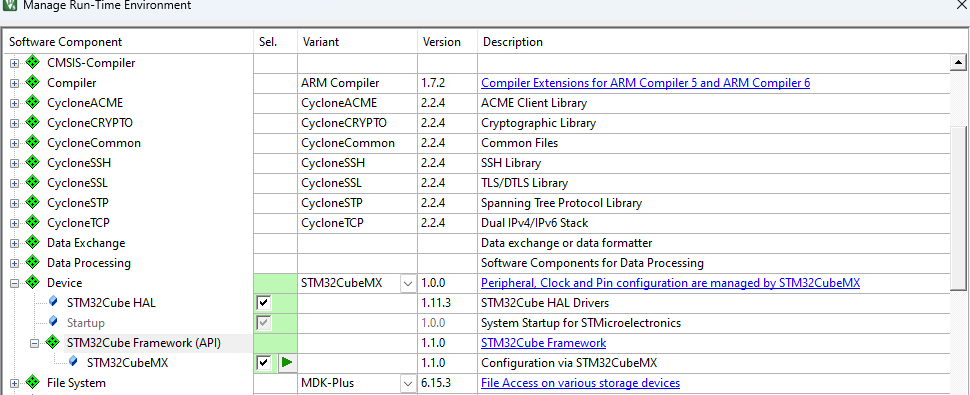

    Thanks for the update, I use keil to make new projects, not stm32cube, maybe the bug comes from there. Please try to make a new project using keil only, there is a checkmark with in the device the triggers stm32cube framework code generation, that I use that for initing peripherals, Please checkout this image
  • Hello Ali,
    Okay, so you're including the STM32Cube HAL directly from within Keil MDK.
    This combination is not something I have used before and since neither product is supported by SEGGER, I'm afraid I can be of limited help here only.
    However, I'd assume that combination to work just as well after applying the modifications I had suggested above:
    • As the project is not generated in STM32CubeMX itself, SEGGER.I-CUBE-embOS_conf.h does not exist in your project and you will need to delete that include from RTOSInit.c.
    • You would need to perform some of the modifications mentioned in our Wiki, especially the modifications concerning the SysTick_Handler() and PendSV_Handler().
      As you're not generating the project in CubeMX, you would need to apply some changes manually (i.e. delete the handler implementations and ensure valid interrupt priorities).
    As mentioned before, for a straight-forward evaluation of embOS, you might also be interested in using embOS for Cortex-M and Keil MDK or, even better, embOS for Cortex-M and Embedded Studio instead.
