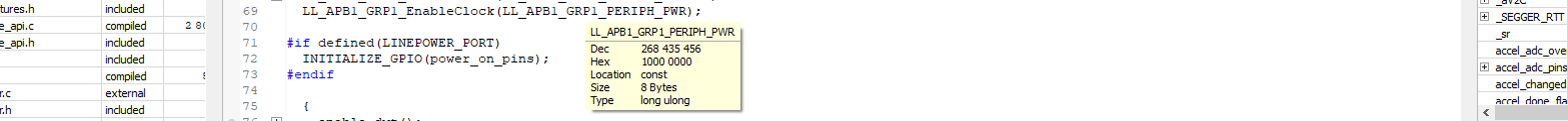

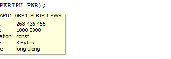

    Just bumped into strange behaviour of Ozone debugger (I am a new user). I created a project on the base of Keil (v5.30) 'axf' file and tried to navigate thru source project variables and definitions but was unable to do it. Right click and 'Show definition' or 'Show declaration' failed to show anything. The only I could get is 'Show.Declaration ("VarName"): No source code declaration information.' and 'Show.Definition ("VarName"): No source code definition information.'. Some variables have an option 'Show value in Source' but it fails too. The same goes for symbol definitions (#define Something).
    In the same time when I hover mouse pointer on specific variable the tooltip appears and shows correct information (see attached picture) but not all #definitions show such tooltip and what is more strange, ver 3.10j shows tooltips while ver 3.30d doesn't for the same definition.
    All source files are loaded ('Source File' widget) so entire information is available. Debug and browse information is enabled for this Keil project ('axf' file contains all the symbols). I am a bit confused of this. Maybe I missed something? Google and forum reading couldn't help me.

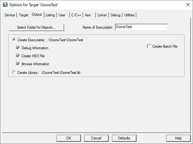

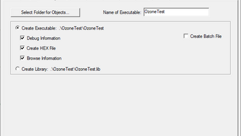

    Also I tried to find appropriate compiler option to overcome the issue but had no success. Initially, the project has settings like this:
    I.e. debug information is already added (this corresponds to compiler option -g) but no file/line data is there as we could see earlier. Armcc User Guide gives no clue (the only option of interest: "--debug" does nothing useful to me).
    So could you please give some advice what is possible to do? (as Keil v.5 toolchain is considered as supported, according to this).
