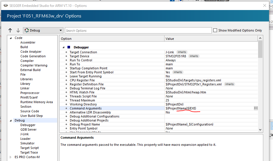

    I have managed to instruct SES to build my elf file by calling a makefile (make all)
    Now, when I select debug/Go, I get a error saying No executable to debug.
    How do I instruct SES to point to my .elf file so that it can be debugged?
    I have attached a screenshot of the setting that I think should have worked but didn't.
    I have made sure that the elf file is in the SAME directory as the .emProject project

  • I didn't try an "external built" project yet, but I don't quite understand the purpose.
    If you build it with a make file inside your IDE and want to debug it afterwards in the IDE, you could do a normal "C/C++" project.
    I view it as an option for projects built with other toolchains, or self-build libraries.
    Anyway, one option would be to try Ozone as debugger.
    And second, I would try to set the "Debug->Debugger->Command Arguments" in the project options to the proper executable file name.
  • I already made the project name the same as the ProjectName.elf so the Debug->Debugger->Command Arguments >> $(ProjectName)$(EXE) is already correct.

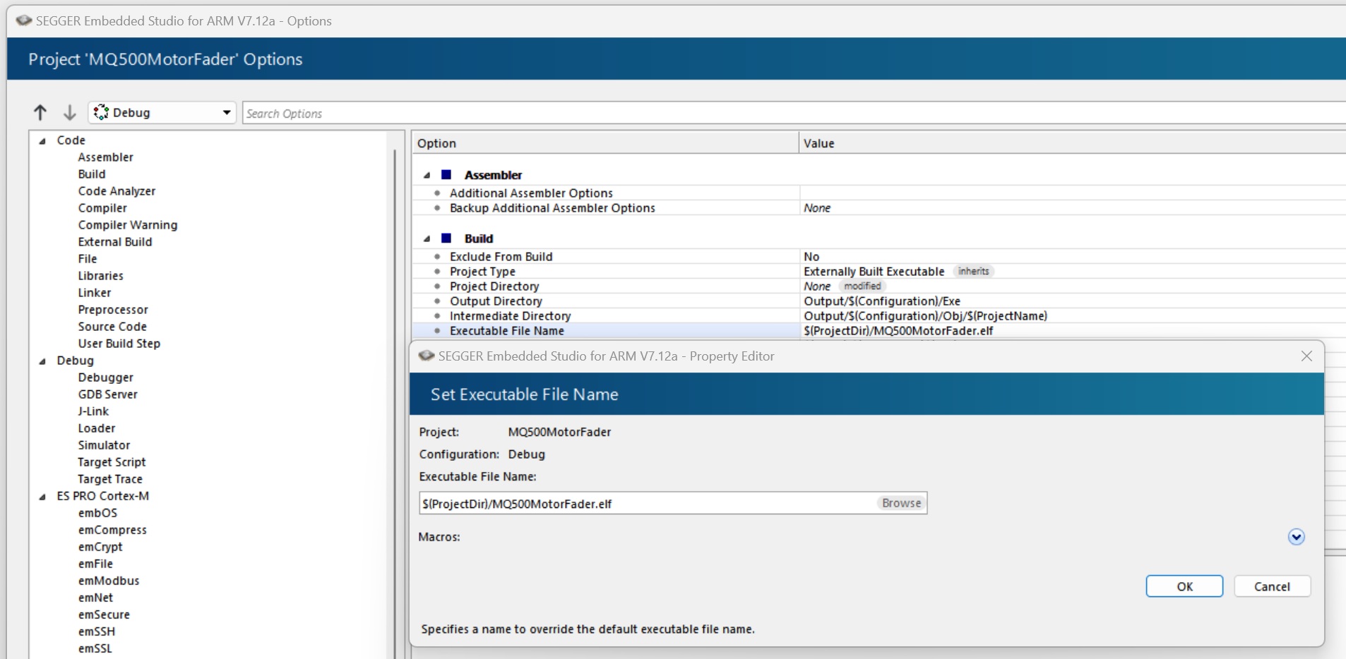

  • This is the layout and settings that I have.
    $(ProjectDir)=C:/Firmware/MotorisedFaders/MyBranch/motor-firmware
    Inside of ProjectDir is another folder called MQ500MotorFader which is where the elf file MQ500MotorFader.elf is generated when the make file is called.
    So, SES has to debug >> C:/Firmware/MotorisedFaders/MyBranch/motor-firmware/MQ500MotorFader/MQ500MotorFader.elf
    Options>Debug>Working Directory = $(ProjectDir)/MQ500MotorFader
    Options>Debug>Command Arguments = MQ500MotorFader.elf
    What more do I need?
  • So, if I "modify" the project type from Externally Built Executable to >> Excutable, debug works which proves my paths etc to the elf file were correct all along. However, I lose the ability to call the make file to build etc.
    I then changed it back to Externally Built Executable to try something out then changed it to Excutable and now it can't find the elf file again even though the projects setting are the same to when it to worked temporarily..
    This feature is broken....
