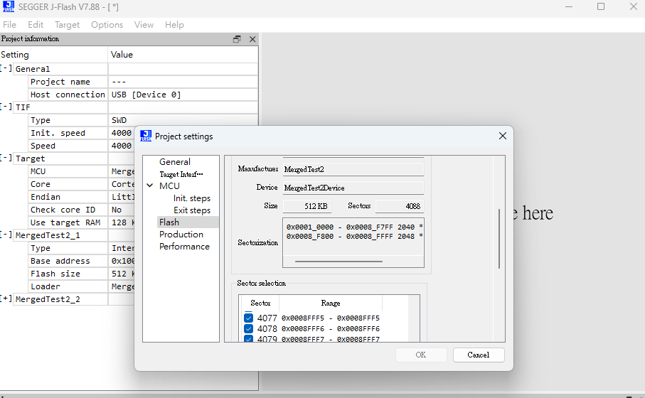

  • Hi Fabian,
    I was told that this has been fixed at v7.88. And I've verified the sectorization shows correctly in v7.88.
    But I am confused that if using multi sector size, how to specify start address of the sector size for each sector is correct? Should the offset with base address or not?
    Ony the Ex_3 will be expected as what I want. Thanks.
    Fabian will be out of office for the next weeks, so please allow me to take over.
    Our wiki contains a description that explains the FlashDevice struct ant its SectorInfo array.
    wiki.segger.com/SEGGER_Flash_Loader#FlashDevice_struct
    E.g.:
    // FlashDevice.TotalSize:// 0x40000//// FlashDevice.SectorInfo[]:// {// SectSize StartAddr// { 0x00004000, 0x00000000 }, // 4 * 16 KB = 64 KB// { 0x00010000, 0x00010000 }, // 1 * 64 KB = 64 KB// { 0x00020000, 0x00020000 }, // 1 * 128 KB = 128 KB// { 0xFFFFFFFF, 0xFFFFFFFF } // Indicates the end of the flash sector layout. Must be present.// }
    This SectorInfo array has sectors of size 0x4000 that go from 0x00000000 (relative to the base address of the flash) to 0x00010000. This means that there are four 0x4000 sectors between 0x00000000 and 0x00010000.
    Above 0x00010000 the sector size is 0x10000 and this block of uniform sectors goes from 0x00010000 to 0x00020000. This means that there is one 0x10000 sector between 0x00010000 and 0x00020000.
    Above 0x00020000 the sector size is 0x20000 and this block of uniform sectors goes from 0x00020000 to the end of the flash (in this case 0x00040000). This means that there is one 0x20000 sector between 0x00020000 and 0x00040000.
    I hope this clears it up.
    Matthias
    From wiki.segger.com/SEGGER_Flash_Loader#FlashDevice_struct the E.g cannot present this issue that if the base address is no start from 0x00000000.
    Take base addess is 0x00010000 for example, the actual address that each size of sectors should be
    sector size 0x4000 should go from 0x00010000 (relative to the base address of the flash) to 0x00020000.
    sector size 0x10000 shoud go from 0x00020000 to 0x00030000.
    sector size 0x10000 shoud go from 0x00030000 to 0x00050000.
    Is my understanding correct?
    If yes, this should be the Ex_1 that I mentioned above. The sectorziation of JFlash seems not expected. Only the Ex_3 could show expectedly.
