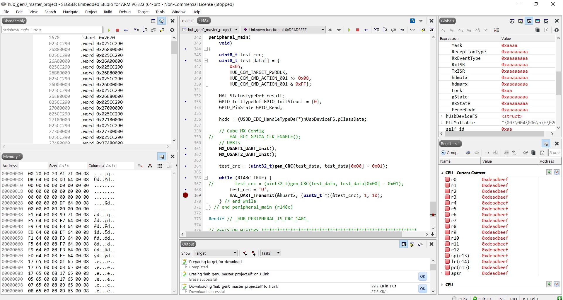

    In our project there is a UART transmission function that didn't appear to produce any output, so I edited the code to call it from an infinite loop so I could get it to just spam characters. In release mode, the code doesn't work but the device is still responsive, however, when I try to debug the code to see what is happening I am unable to do so. The two screenshots show the result before and after trying to enter the HAL_UART_Transmit() function. Everything appears normal here at the breakpoint; however, after I click in the assembly view and attempt to step into the function I get what you see in the after picture. The memory views on the right are giving bogus values and I have no idea what the debugger thinks is happening as I can no longer move through the code. I have no clue what I should be looking at here to resolve the issue. The project goes over the 1Mb attachment limit so I can't include it, but it is compiled under SES Release 6.32a Build 2022062102.50602. The board hardware is very simple, a JLINK is attached to Reset, GND, and SDIO/CLK. BOOT0 is wired to ground and an o'scope probe is on PA2 (UART channel 2 TX).

    Everything craps out at the function prologue assembly for HAL_UART_Transmit() : ldr r0, =0x200007D8 <huart2>. I know bad things happen when we de-reference illegal areas of memory, but this command is just loading the address into a register. At this stage all the initialization for this function have been commented out.
    I've been using the "Debug - Internal" build with no ST library issues until I added the UART (this includes working with ADC, USB, and I2C) and optimizations set to "none". I can try doing the IDE update.
    EDIT : Did the IDE update; getting same results.

    The score register values "0xdeadbeef" and "0xaaaaaaaa" for variable hown in your case suggest that something is messing with the debug peripheral.
    The first one ("0xdeadbeef") looks suspiciously like a stack/memory initialisation value to check for runtime overflows.
    I never devoted much time to study debugger internals or Cortex ETM/ITM peripherals ...
