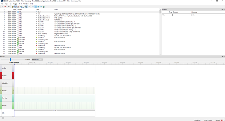

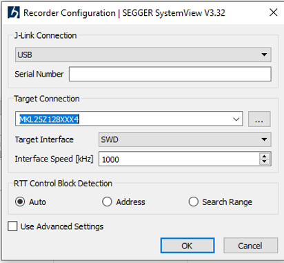

    The system view in PC find the correct parameters of my board, when it is attached to PC when selected "Target->Recordes Configuration" (image 1).

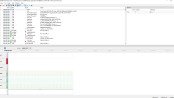

    When the FRDM-KL25Z is attached to PC, I click in the "start recording" and it begins to record (image 2).
    However, some problems appears in the visualization.
    First of all, the time scale and value is wrong. After many seconds periods, the time scale is show in few miliseconds.
    Second, I have to move the cursor in front of the timeline window whenever I want the system view to update the tasks view, which is really annoying.
    Third, there are Tmr Svc and Idle timelines that show nothing. I believe something should be shown in Idle, but not sure with Tmr Svc.
    And finally, is there a way to change the color of tasks on the timeline? This default color is very transparent and similar to each other, which makes analysis difficult.
    What can I do to resolve this problems?

    Could you try using the latest SystemView sources and SystemView version? You seem to have a version mismatch there.
    Additionally here is a Wiki article describing how SystemView should be used on FreeRTOS:
    wiki.segger.com/FreeRTOS_with_SystemView
    For more details about troubleshooting see the SystemView reference manual.
