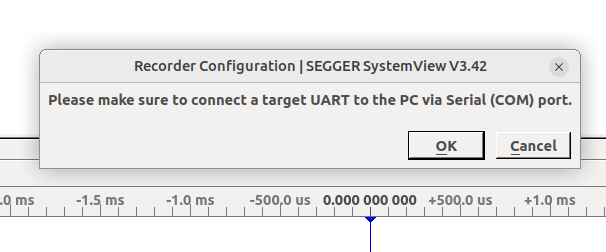

    Hi all,
    As in the topic.
    In the recent linux version of SystemView (3.42) after I set serial port as the way of recording events normally I should be redirected to dialog where I can choose serial port. Instead of this I can see this dialog:
    I compared to previous version and in 3.20 everything is ok.
    Am I missing something?
    Pawel

  • I checked other linux (ubuntu) computer with the same result - in recent version it doesn't work
    I also checked text strings in app and it looks like before SystemView was looking for serial ports in different locations
    So 3.20
    /sys/class/tty/
    and 3.50
    /sys/bus/usb-serial/devices/
    The latter limits serial ports only to usb devices I think. It would be nice to revert it.
  • I can confirm the behavior under Debian testing: v3.30 works with UART, v3.32 shows described box and then no communication via UART. v3.50a has the same (wrong) effect.
    Edit: happens with 64bit .deb and portable version as well
    We were able to identify the cause of the issue and it will be fixed with the next SystemView release.
    To get notified automatically when it becomes available we recommend to subscribe to our release notification mailinglist:
    segger.com/notification/subscribe.php?prodid=7,204
    As a workaround we recommend to use older SystemView versions for now.
