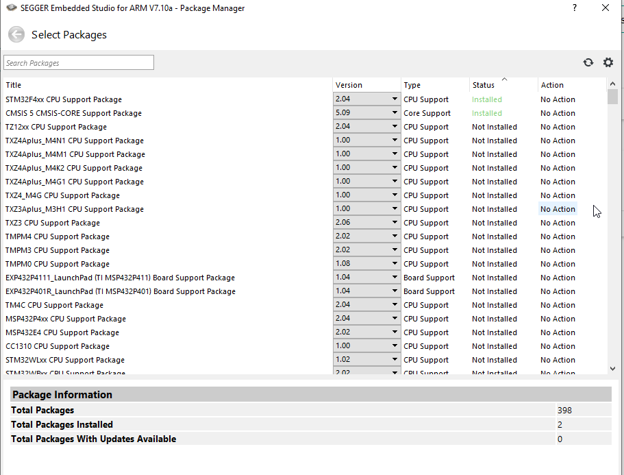

  • SEGGER - Nino wrote:
    To fix this all you need to do is to use the latest STM32F4xx package from the ES package manager and create a new project with it with the latest Embedded Studio version.
    Then all startups and handlers that are required for this should be set up correctly and your sample application will work as expected and print random numbers.
    Can you confirm that creating a new project with the latest files works for you as well?
    No, it is still not ok. Please find the screenshots attached:
    - Version is Embedded Studio 7.10a, all packages up-to-date
    - Create new STM32F4xx project, STM32F405RG target, C/C++ executable
    - Leave everything as default, only change debugging target to Simulator in Project options
    - You can see in the generated code stil the offset is wrong
