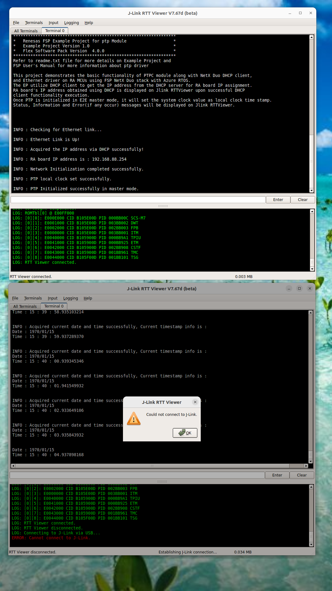

When I run 2 instances of e2Studios and start debug session in both of them, it works. Then I open RTT Viewer and connect one of them it also works, but as soon as I open second instance of RTT viewer it says it can not connect. as seen below
[Blocked Image: https://community.renesas.com/resized-image/__size/640x480/__key/communityserver-discussions-components-files/48/pastedimage1670885563057v2.png]

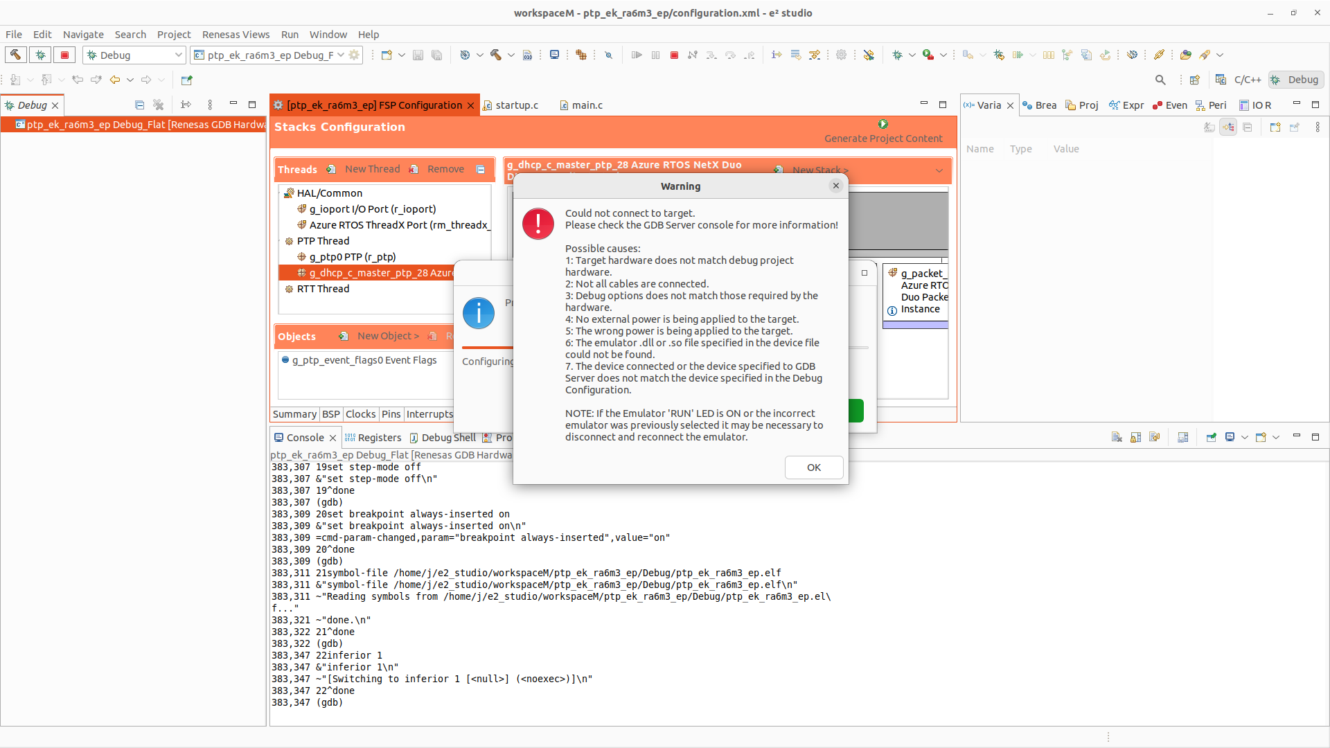

And if I open 2 instances of RTT viewer and then try to debug from e2 studio , no debugging session starts and error is thrown as below
[Blocked Image: https://community.renesas.com/resized-image/__size/640x480/__key/communityserver-discussions-components-files/48/pastedimage1670885425065v1.png]
Also it kills rtt viewer session.
I have tried Jlink driver version v7.82f and v7.67d both Linux 64 bit DEB installer.

THERE is no problem doing this on windows 10. [i.e. running 2 e2studio debugging session as well as 2 rttviewer session]
basically here project and board doesn't matter, you can choose any two boards and any project and just start debugging and rttviewer in ubuntu , you will see the problem.
It seems like GDB server is allowing only three connections in Linux. It can be 2 IDE and one logger or 2 loggers and 1 IDE.
Actually I connected 2 EK-RA6M3 and 2 EK-RA2A1 boards and run RTTViewer and all four worked fine, i.e. I could see the logs from all four boards.
So, when Debugging is triggered by e2Studio via e2-gdb-server only then this issue is triggered. I think if you eliminate rttViewer and just try to start debugging sessions on 4 boards in Linux you will have the same
ALSO when I attach 2 separate debuggers (not OB) and try to debug using e2studio , the same problem occurs, If I debug both of them, I can only connect one of them using RTTView. there is some limitation with 3 conections.
