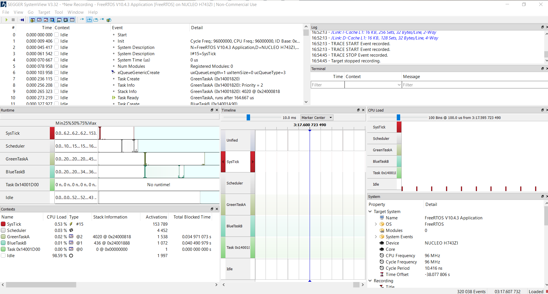

    I'm using SystemView to analyse FreeRTOS on STM32H743.
    I created 2 simple tasks: "GreenTaskA" and "BlueTaskB".
    But SystemView shows that there is another task "Task 0x14001D00". I don't understand where does it come from.
    Can you help me? Thank you.
    FreeRTOS will create some tasks on its own. So you simply need to increase the value of SYSVIEW_FREERTOS_MAX_NOF_TASKS until all task names can be resolved.
    Just make sure to do a rebuild after changing the value and redownloading the new application.
