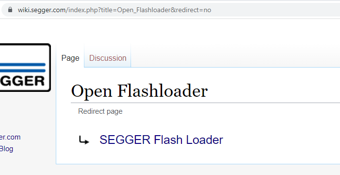

    I tried downloading the latest open flashloader template using the following link: wiki.segger.com/Open_Flashloader
    The flash loader page is empty and I cannot find another reference to the open flash loader. Where can I download the template?
    We have applied to some major changes to the templates resulting in a massive performance boost.
    The now called SEGGER's high performance flash loaders (templates) are part of the J-Link Development Support Kit (DSK):
    wiki.segger.com/J-Link_Device_Support_Kit#DSK_availability
