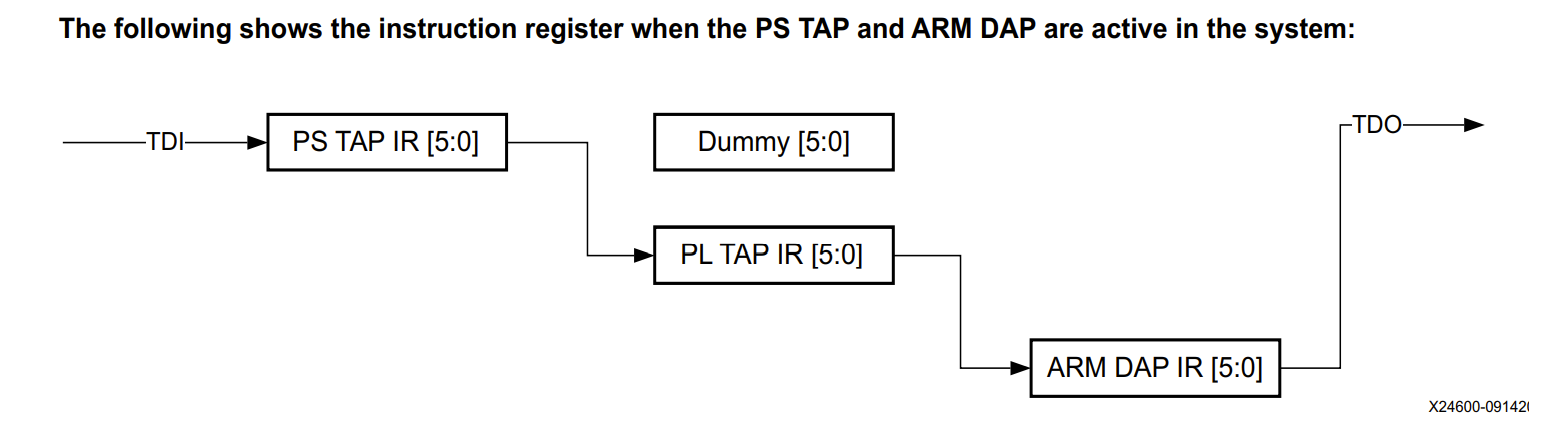

    I have removed the setup target function. Here is a logfile that was produced when running it again. One thing that might be useful to note. The output above where it can identify the El1-3 and debug architecture only appears when the core is halted before hand and our board is not running properly. When we have restarted the machine and everything is running well we get this output where we are having issues with the CPU-TAP. One thing this might be from is that we are using a Xilinx board with a J-Tag chain which has changed in their documentation. We are using a Zynq Ultrascale+ .
    Note: They specify above in their TRM that the JTag-chain length is always 16 bits but this diagram has it at 18 bits in length.Here is the previous version of the document
    And updated
    Here is the Log file
    That's easy: The diagram is garbage.
    The ARM DAP is IR = 4 bits wide, so [3:0] and not [5:0], making the chain: 6 + 6 + 4 = 16
    Also, setting up the JTAG chain is not sufficient because the ARM DAP must be explicitly enabled (UltraScale+ specific)
    An excerpt from the script to enable access to the Cortex-R5 below.
