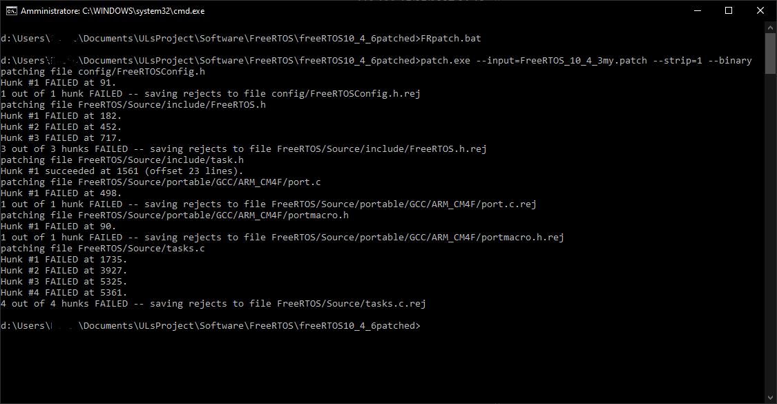

    Hello forum users,
    do you know if patch file to modify FREERTOS kernel version 10.4.6 for use with SystemVIEW V330 exists?
    I tried one provided inside "SystemView_Windows_V330_x64.zip" but the differences between OS version from which it was generated and 10.4.6 are too big and patch cannot be applied successfully.

  • Thank you Nino for pointing me to updated patch file.
    I tried to apply this patch created for 10.4.3 to version 10.4.6. It still fails on many points.
    I attach screenshot and also "rej" files.

    OK it seems that FreeRTOS is incompatible again after a "minor" update... great...
    We will put a patch for FreeRTOS 10.4.6 on our wishlist, but can't promise a fixed time schedule as our resources are quite booked right now.
    You can of course manually patch the corresponding areas of the newer FreeRTOS yourself.
    As reference you can use the 10.4.3 patch and the SystemView manual which describes in general how any application or RTOS can be instrumented.
