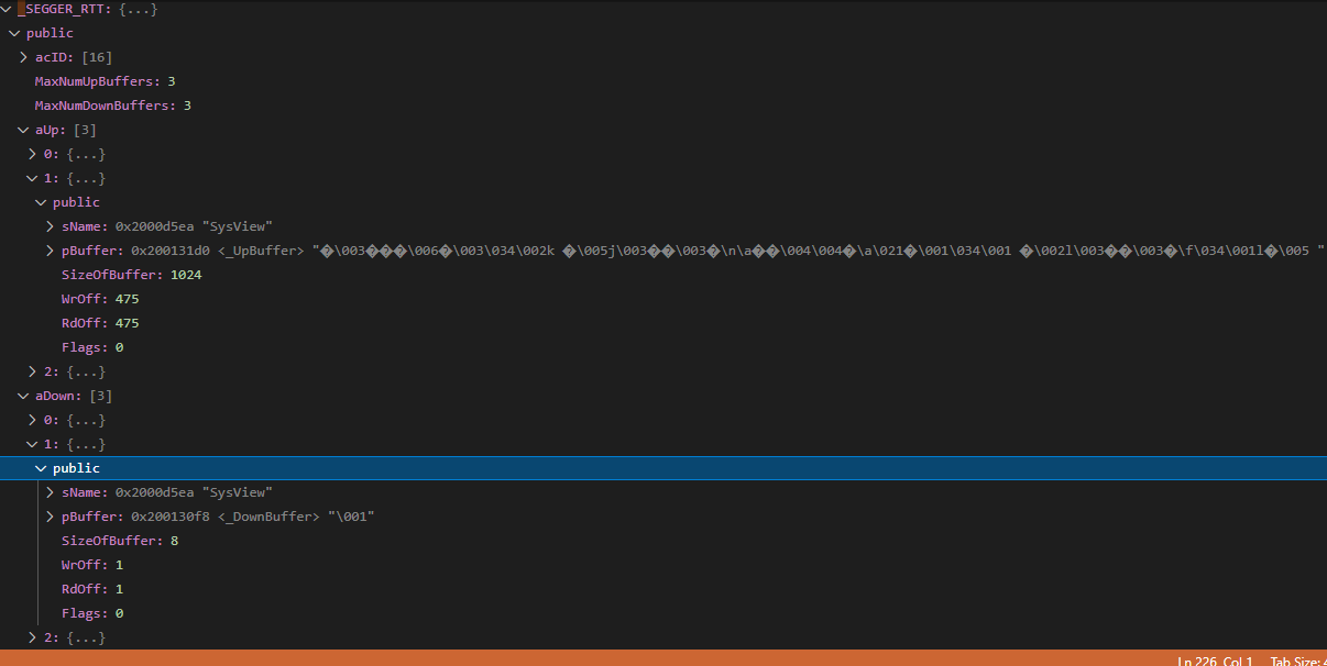

    But in these further experiments I've found that the problem is not restricted to SystemView.
    I have a terminal configured on RTT channel 0, which works fine if I connect with JLink RTT Viewer.
    While RTT Viewer is connected, I can run JLink Commander, and the Viewer terminal still works fine, whether or not I've told JLink Commander to connect.
    I can also (without involving JLink Commander) run SystemViewer while RTT Viewer is running, and use the terminal, and everything still works fine.
    Likewise I can start SystemViewer first, and then connect from RTT Viewer, and both work.
    In both these cases, if I stop whichever of the two was running first, the other reports that it has lost its connection - which I guess is because the "main session" has closed as you described.
    BUT, if I first run JLink Commander and connect to the target, and then connect from RTT Viewer, Viewer reports "RTT Viewer connected" but the terminal doesn't work, and it displays e.g. "WARNING: Sent 0 of 2 bytes" when I send a line. Quitting Commander causes Viewer to report "ERROR: Failed to read RTT data. Disconnecting".
    If I immediately reconnect Viewer, it reports "RTT Viewer connected" and the terminal works perfectly. (The target has _not_ been reset or restarted, and is alive and running throughout this process.)
    Likewise if I run JLinkGDBServer and attach from a GDB client, connecting from RTT Viewer doesn't work properly.
    If I exit the GDB Server, I can immediately connect and use RTT Viewer.
    All very frustrating.
    I just gave this a try with a RP2040 and it appears that the automatic RTT search range for the RP2040 is not complete in J-Link software.
    Which is most likely the cause of the issues you are seeing and why we could not see any issues with other Cortex-M target devices.
    We will add the remaining RAM sections of the RP2040 to the automatic RTT search ranges as well. But for now you need to set the RTT Control Block address manually via SystemViews recorder settings.

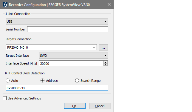

    Now attached you will find an example SystemView Application for the RP2040 Pico. It uses embOS and blinks the LED.
    Could you open J-Link Commander and erase your target device and program the attached hex file with command loadfile?
    Then use commands reset and go. Do you see the LED blinking?
    If yes, leave J-Link Commander open for now.
    Now open SystemView V3.30.
    Go to Target->Recorder Configuration and make sure it looks as shown in the screenshot below.
    Now start the recording.
    Do you see SystemView recording even though J-Link Commander is running?
    If, yes everything is working as expected. If no, could you provide screenshots of what you see and provide a J-Link log of the failing session?
    Now if it worked the same approach will work when using J-Link GDBServer.
    Can you confirm that this manual setting of the RTT Control block address works for your application as well?
    You can find the location of the control block in your application by searching for symbol _SEGGER_RTT in the map file.
    Alternatively you could link symbol _SEGGER_RTT into RAM between 0x20010000-0x20020000 as this is the area that is currently being autosearched.
    Regarding RTT Viewer. If you first start a Commander/GDB Server session you need to select attach mode, otherwise it will not work. But that is unrelated to the SystemView issues you are seeing.

  • OK, it works with your LED blinker. So evidently my software is doing something wrong - but only just wrong enough such that it works when SystemView connects exclusively.
    Here's the JLink log for my program:

    So it looks like the RTT control block is being located and parsed OK, and the various buffers, labels etc located & read.
    It would appear the problem is associated with the following:
    T3518 028:948.550 JLINK_RTTERMINAL_Read(BufferIndex = 1, BufferSize = 0x00002800)
    T3518 028:948.660 - 0.119ms returns 10240
    That return value looks highly suspicious, especially compared to the corresponding return values when running the LED blinker, which are always a few hundred bytes maximum.
    I've examined all the structures in the RTT control block, and they seem valid (screenshot attached). The uplink RxOff and WrOff values suggest that the uplink data has been successfully consumed.
