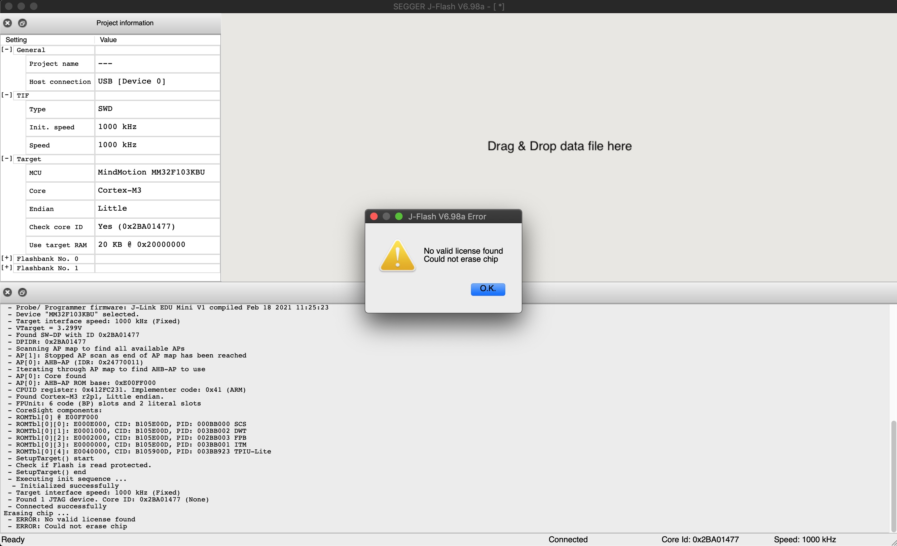

    This is my first post, thanks for accepting me on the forum.
    My colleague and I have issue with J-Link Edu after recent upgrade of J-flash. As hobbyists, we want to create a controller for garden irrigation, based on 5V STM32 clone.
    Unfortunately after upgrading J-Flash we get errors as in screenshots. The same happens for both windows and macos.
    When buying the J-Link Edu, I assumed the only limitation is related to commercial use
    Could you please help out?
    Tom.

  • Hi Tom,
    Actually, from a software license point, the J-Link EDU and EDU mini have more licenses then a J-Link BASE (SEGGER's cheapest commercial J-Link):
    segger.com/products/debug-prob…erview/#software-features
    However:
    A J-Flash license does neither come with the J-Link EDU nor with the J-Link Base models.
    A J-Link Plus or higher is required for this (see link above).
    The reason why this did not appear for you before when using the EDU Mini is that J-Flash had a bug in one of the older versions, where the license check did not work correctly in some cases.
    In general:
    J-Flash is a production utility, which should not be required for debugging & development.
    For these cases, the J-Link Commander should be sufficient (e.g: erase range via "erase <range>" command, chip erase via "erase" command, flashing a datafile via "loadfile" command...).
    It even comes with an option to make it scriptable.
    For further information, please refer to:
    wiki.segger.com/J-Link_Commander
    You could also use use Ozone (SEGGER's debugger solution) which comes with a lot of useful features and is also usable FOC with the EDU models:
    segger.com/products/development-tools/ozone-j-link-debugger/
    Does this answer your question?
