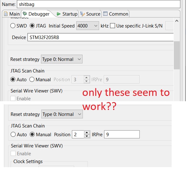

    Hello, I have a 4 identical microcontrollers daisy chain wich seems to work...exept I detect 8 devices?... My setup is the folowing...I have a segger J-link edu mini and 4 wire JTAG. basically I dont got JTRST but NRST connected to the J-link... In tis event should my reset strategy be Type 0:Normal or None?? Boot 0 is shorted to GND.
    Something seems to work, as I can enter the debugging session and get this log below. But my true goal is to precisely select ny microcontroller on this chain and debug this and get to work. I seem to be only able to program tap #auto(position 0?) and position 2... Why IRPre9?? No idea...Saw this in a post.
    J-Link found 8 JTAG devices, Total IRLen = 36

    Anyways, this is not my main problem, I am just confused as to why I get this effect, no numerical combination of position and IRPre seem to work.
    Any help would be appreciated, Please shed light on this issue?

    To answer your question:
    For using the JTAG position, you need to understand how JTAG
    works.
    One MCU/chip may contain more than 1 JTAG device (there may be
    several ones chained inside a single chip).
    For the STM32F2 for example, there are 2 JTAG devices per chip.
    #0 JTAG-DP (debug TAP), IRLen: 4-bit
    #1 STM32 boundary scan TAP, IRLen: 5-bit
    To address a specific JTAG device in the chain, you need to
    specify the position in the chain.
    The position is composed of:
    1) Number of JTAG devices closer to TDO than the one you want to
    communicate with
    2) Sum of IRLen of all JTAG devices closer to TDO than the one you
    want to communicate with
    See here:
    wiki.segger.com/UM08001_J-Link…devices_in_the_scan_chain
    It also comes with some explanations.
    For your case, the chain looks like this:
    TDI -> #7 STM32-BS -> #6 JTAG-DP -> #5 STM32-BS -> #4
    JTAG-DP -> #3 STM32-BS -> #2 JTAG-DP -> #1 STM32-BS ->
    #0 JTAG-DP -> TDO
    You want to connect to the JTAG-DP which is responsible for
    debugging.
    So the following combinations are valid for CubeIDE:
    Position: 0 IRPre: 0 (#0 from above)
    Position: 2 IRPre: 9 (#2 from above)
    Position: 4 IRPre: 18 (#4 from above)
    Position: 6 IRPre: 27 (#6 from above)
