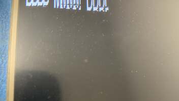

    • Thank you for the explanation, Sven.
      I tried the sample code and was able to display this. Please see attached. I don't understand why I see characters displayed repeatedly. Could you please help me understand this behavior?
      Thanks and regards,
      BMD
      No, it's the same procedure. Create a font, e.g. by calling GUI_XBF_CreateFont((GUI_FONT*)&Font, &Data, GUI_XBF_TYPE_PROP_AA4_EXT, _GetData, pFile), and use the initialized GUI_FONT structure for your widget. Just make sure it stays valid as long as any object uses the font.
