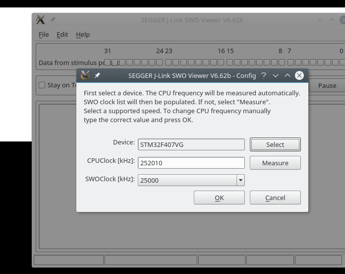

    Since either my JTrace don't work correctly wtih STM32 board:
    The given reference board is STM32507VG (which is included in JTrace port. The program was micropython default build for STM32F4DISCOVERY.
    Since my STM32f427 board doesn't work well with ETM, I tried to use ITM PC sampling. However, mu current JLink board seems to suggest much higher CoreClockCpus, e.g. STM32F407 has just 168 MHz, but SWViewers showed estimated clock rate 252 Mhz.
    After measuing the responses and parsing with sigrok I understood to get the vale from CPUClock/prescaler to SWO it would be easier setup the CPU clock in the 253 MHz range, to get some reasoneable results:
    With using the real 168 MHz the measure baudrate is 3428571 when it should have been 2250000.

    It appears that the clock initialization of your target application is not correct.
    For reference could you give the attached example project a try?
    You can rebuild and flash it using Embedded Studio:
    segger.com/products/development-tools/embedded-studio/
    If you now start the SWO Viewer. Does it work as expected?
    The default clock in this example is 16 MHz.
    If you edit the example project to initialize the core to 168 MHz. Do you see the same behaviour?
    If yes could you attach the modified project?
  • OK, solved this. Apparently STM32 Cube IDE sets prescalers, etc. wrong and SWOViewer acts weird.
    I got it working via gdb scripts from orbuculum, this enables SWO ITM PC sampling, core clock 168 MHz, SWO baud rate 2Mbaud. Commands for GDB:
