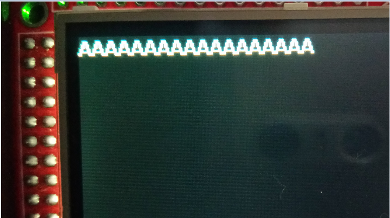

      I'm working on STemWin532 library on STM32F103ZET6 bord in STM32CudeIDE. I could successfully configured LCD interface (The Controller is HX8325B and GUI runs on internal RAM) and insert some text on the screen (image 1)

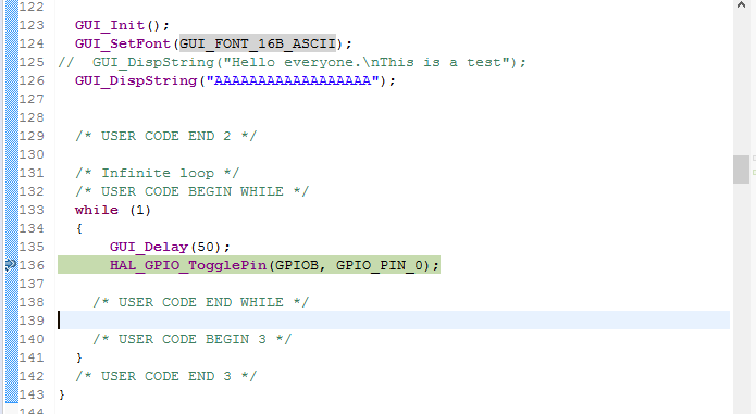

      But when i use external SRAM as GUI memory result is very strange and interesting :). The text is driven out of the screen. The picture 2 shows the situation.
      While the code is the same code that works correctly in the internal RAM of MCU. The only command that i changed is the following variable definition for GUI memory allocation:
      C Source Code: GUIConf.c
      1. #include "GUI.h"
      2. #define GUI_NUMBYTES 1024*50
      3. U32 static aMemory[GUI_NUMBYTES/4]; // This is for internal RAM
      4. U32 static aMemory[GUI_NUMBYTES/4]__attribute__((section(".GUI_0x68000000"))); // This is for extenal SRAM
      5. void GUI_X_Config(void) {
      6. GUI_ALLOC_AssignMemory(aMemory, GUI_NUMBYTES);
      7. }

      Build Analyzer output of CudeIDE shows the memory usage as image 3.
      There is no hard fault in execution procedure and while(1) loop is executing as normal:. (image 4)
      Any help will highly appreciated.
