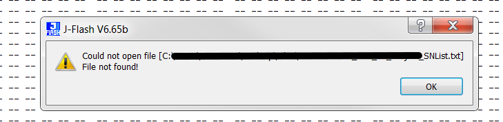

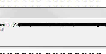

    ## If I mark the SN checkbox, JFLASH programs the SN well, but it sometimes says that it can't find the "...SNList.txt" (see attached image).

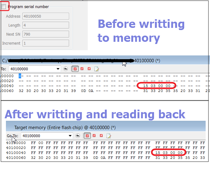

    1) If I never mark the checkbox --> The ".srec" file is not updated with the SN and it is not saved in flash memory, regardless of the "...Serial.txt" file exists or not.
    2) If I mark the checkbox --> do some SN programming --> deselect the checkbox --> do more programming --> The last serial number is burnt in memory from that moment on.

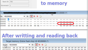

    I noticed that the related loaded ".srec" file memory area was updated whit the SN when when programming the first time. However that area is not cleared when programming the second time (see attached image).

    We were not able to reproduce the error message you receive, also the error message seems to be from V6.65b, not V6.70.
    I suppose something was mixed up here?
    The behavior you describe is intended. The (*) above the file is indicating, that the data in the file was changed.
    We do not "clear" the SN area, because the user might not want to have this area "cleared" and we do not want to assume what the expected "cleared" value is supposed to be.
    If you want to program the data file without the SN, I suggest you open the original data file without saving the changes.

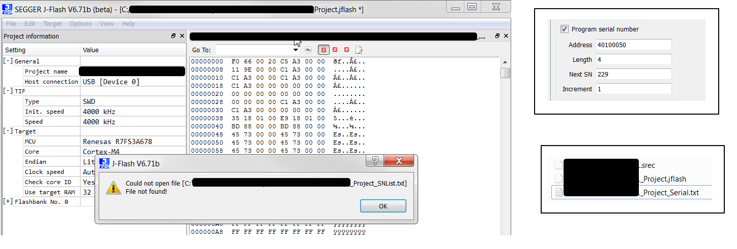

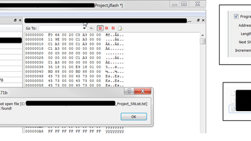

    This issue persists in the last version V6.71b (see attached image). JFlash always says it can't find "_SNList.txt". That file is not inside my project folder because I don't want to use SNList. I would like to use "_Serial.txt" file, that is created automatically by JFlash because I want to burn consecutive Serial Numbers. Or is "_Serial.txt" no longer used by JFlash in recent versions?
    Ok, I'll do this way.

    We were able to recreate the issue and are looking into it.
    We found the root cause of this problem and fixed it.
    The fix will be part of the next patched release, planned for later today (6.70g).
    It will be uploaded here:
    segger.com/downloads/jlink#J-L…twareAndDocumentationPack
    Could you please try this version and come back to us if everything works as expected?
  • Hi Fabian,
    I tried the new version 6.70g and it works fine. I couldn't reproduce the previous issues.
    Now, JFlash creates and reads the "...Serial.txt" file well, and the "...SNList.txt" is not requested all the time.
