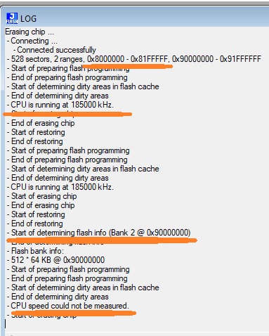

  • Today I noticed another detail. When I start erasing in J-Flash, I see in the log that when erasing the internal memory, the CPU is running at 185 MHz. And when the external memory is erased, the log says: CPU speed could not be measured.
    What does that mean? What am I doing wrong initialization? Here is the code of my function init.
    C Source Code: FlashPrg.c
    1. int Init(U32 Addr, U32 Freq, U32 Func)
    2. {
    3. U32 v;
    4. (void)Addr;
    5. (void)Freq;
    6. (void)Func;
    7. driverInit(); //init gpio and qspi
    8. int result = ExtFlash_Init() ? 0 : 1; //try read jdec id and ret 0 if success
    9. if (Func == 3) { //if read operation -> turn on qspi memory mapped mode
    10. ExtFlash_SetMemoryMappedMode();
    11. }
    12. return result;
    13. }
    As you can see, I ignore the Freq parameter. Do I have to manually configure PLL in the Init function?
