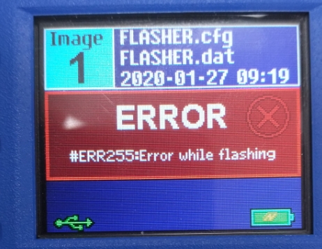

    Hello.

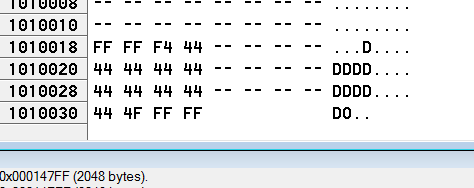

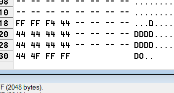

    I'm using an S3A6 microcontroller from RENESAS, JFLASH software (v 6.62) and FLASHER PORTABLE PLUS. I'm trying to program the ID-CODE protection that is stored at address 0x1010018.

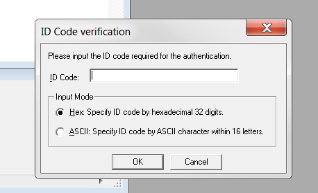

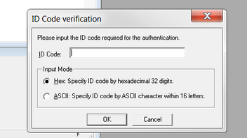

    When programming in J-LINK mode (Target -> Production programming F7), the entire code is downloaded correctly and the PCB works well. From that point on, whenever I want to program/erase the S3A6, J-FLASH shows the expected "ID Code verification" window.

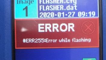

    The problem comes when I try to do the same in Stand-alone mode (the microcontroller memory has been completely cleared before). I go to "File -> Download config & data file to Flasher" to update the FLASHER PORTABLE internal memory.Then, I push the FLASHER PROG button, but the FLASHER shows the next error: #ERR255: Error while flashing.
    Why doesn't the FLASHER PORTABLE PLUS work this way?
    Note: The FLASHER PORTABLE PLUS works well in stand-alone mode when I don't include the ID-CODE.

    we currently do not have an API in the Flasher Portable Plus to read an IDCODE from a file.
    Such an API is under development, but it does not have a high priority and I cannot give you a schedule.
    If you are interested in a faster development for NREs, please open a ticket:
    segger.com/support/technical-support/
    Arne
