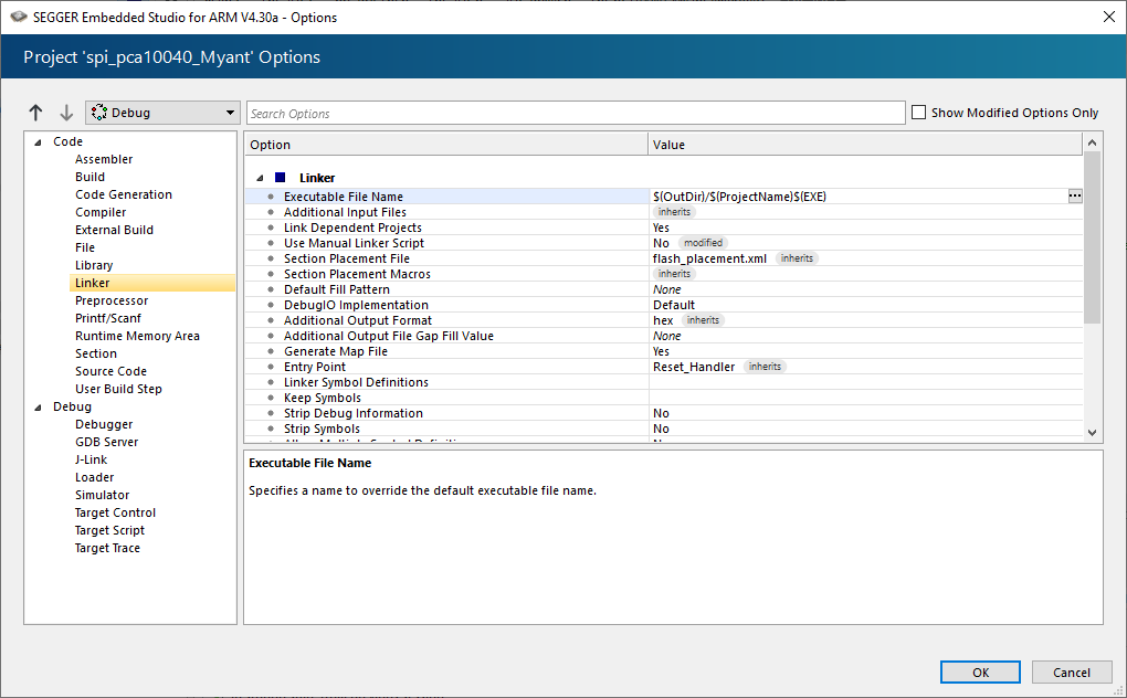

    Hey guys, I'm starting with SEGGER and I'm having problems to link an external library (.lib file) with my project. Is this kind of file supported by SEGGER? Attached is the screen showing how I tried to include the external library.
    This is a third-party library and I don't have the source files to compile it by my self.
    Thanks a lot for any help.

    If it is a C or C++ library you can use it in Embedded Studio.
    To use it simply set it in project option additional input files.
    Are you using the Segger linker, or GCC ?
    The library would have to be in a format supported by whichever Linker you're using.
    It would also have to use a calling convention compatible with the compiler that you're using ...
