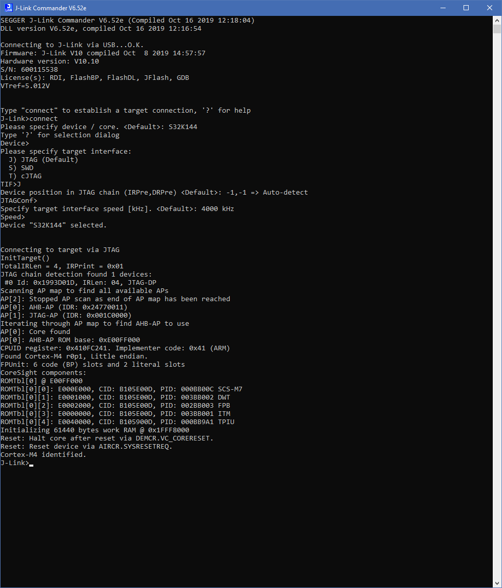

    I recently purchased a J-Link and a S32K144EVB to start development with. When I tried to set up my J-Link Flash connection it gave me the message "Unexpected core ID." I have searched around and could not really find any information on this. Below is the output from J-Link Flash. Looking to see if I am doing something wrong or if I somehow need to change the expected Core ID the J-Link Flash expects.

    I have noticed in another thread the S32K148 has a similar ID. Here is the excerpt for the post
    krzemyk wrote:
    Connecting to target via JTAG
    InitTarget()
    TotalIRLen = 4, IRPrint = 0x01
    JTAG chain detection found 1 devices:
    #0 Id: 0x0995001D, IRLen: 04, JTAG-DP
    We were not able to reproduce the warning with the EVB boards we got form NXP.
    However they have engineering samples on them so it is possible that these values have changed in the actually shipped cores.
    We will order additional boards from a more current batch and see how they compare.
    EDIT: Scratch that, we have one with a current production MCU and there it works as well.
    Do you see this issue with other EVB boards as well?
    Could you check your power supply to the target if it is stable 5V?
    Could you provide a screenshot of a J-Link Commander session?
    wiki.segger.com/J-Link_cannot_…ty_using_J-Link_Commander
    The ID output by your target device looks completely wrong. The last 4 digits must be 0x0477 for Cortex-M.
    So either NXP made a huge mistake here or the ID is not transferred correctly to J-Link.
    How are you connecting to the target device? Are you using our official cables/adapters?
    segger.com/products/debug-prob…s/9-pin-cortex-m-adapter/
    Nonetheless the warning should not have impact on your Debug or Flash experience.

    The target did say 5V, but I will provide a screen shot tomorrow of the J-link commander. It also had the ID of 0x1993D01D if I remember correctly
    I am using the official SEGGER 9 pin connector. I have a 19 pin connector as well
    I am connection to J14 on the EVB
    CG
  • Nino,
    Some additional information. See J-Link Commander Screen shots.
    Connecting Via the JTAG interface yields the incorrect ID
    Connecting via the SWD interface gives the correct ID
    As this is the first ARM project I am not sure if this is normal or not.
    Thank you for your additional information.
    Unfortunately the behaviour was not reproducible on the boards we have in house so far.
    We will see if we can get our hands on other samples.
    Nontheless the message should in no way impact your debug experience and you can simply ignore it for now.
    Once we can reproduce the behaviour we will see how it could be fixed.
